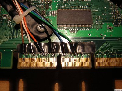

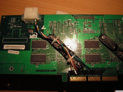

Reply 16 of 21, by Cga.8086
i think i found the pictures:
https://www.techpowerup.com/77529/3dfx-sfft-1 … r-released?cp=2
http://www.3dfxzone.it/enboard/topic.asp?TOPI … 626&whichpage=1
http://falconfly.vogonswiki.com/cgi-bin/yabb2 … ;num=1185303152
notice how he did cut the card, and then tied some pins to 3.3v
    361.5 KiB
    1622 views
    354.53 KiB
    1622 views

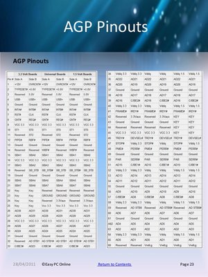

Reply 17 of 21, by Cga.8086
pinout,something to watch out since notice #47 he soldered to a point in sida A point, but the point must be going to side B
