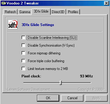

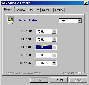

Reply 10 of 14, by Errius
It's been running the Quake demos for several hours without problem. The fan clearly makes a difference. Adding heat sinks to the chips sounds like a good idea.
I also had a look at the tweak utility, but refresh rates are already at their lowest settings and the pixel clock is at 93%. Is this normal or have these settings already been modified?
Is this too much voodoo?
Reply 11 of 14, by bjwil1991
Those are normal. I'd suggest underclocking to 75MHz for both Glide and Direct3D to put less strain and heat to the chips. Mine was at 93MHz and I downclocked them since it's in a very fast computer.
Reply 12 of 14, by Errius
These are the current settings. I have not changed anything.

Reply 13 of 14, by Munx
The default speed of these cards is 90Mhz. They are actually overclocked now.

Reply 14 of 14, by Errius
Card is running well at 75 MHz with the fan off. The chips are still hot but noticeably cooler than before.
There's no noticable slowdown. It's running on a 1 GHz Pentium III computer. Is there a Fraps-type frame rate utility for Voodoo cards?
ETA: Note that the underclock is done in software not hardware. This is a dual boot Windows 98 SE/Windows ME machine. I set the underclock in W98 and it still shows as 75 MHz after reboot. However when I boot into WME it shows as 93 MHz again.
