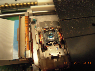

The Plextor PX-708A that arrived yesterday did not recognize any media.
So I said to myself, I'll open it, just my curiosity about the innards are worth the 10 euros I spent for the recorder (including shipping).
I liked what I saw.
But, look yourself.
file.php?mode=view&id=121736
This looks like the old Plextor CD writer I mentioned above.
Boy, it is dirty!
But, all mechanical parts easy to reach and clean!
I need a vacuum cleaner, but it is too late for this today.
So maybe it is indeed bona fide Plextor.
I absolutely won't be surprised if it works fine after cleaning and relubing, because even the lens is covered with a thick layer of dust.
But maybe I'll just destroy it, if I slip... then this won't be OT anymore 😀

That does totally look like the chassis and mechanism from a Premium/PX-W5224TA/PX-W4824TA, but the laser pickup is completely different.
The pickup is a lot bigger and the ribbon cable is twice as wide. Can you post a picture of the board?
I usually disassemble dirty drives like this completely and wash everything with Windex (except the laser!), then rinse with warm water, immediately shake it out, dry with paper towels, then evaporate all visible moisture with a blow-dryer on medium power, and then leave it to air-dry overnight.

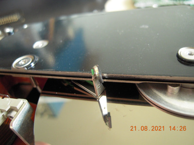

ruthan wrote on 2021-10-16, 22:24:
... nice fragging.
Oops yes! Anti-Conner violence. Not today, but nice anyway 😀

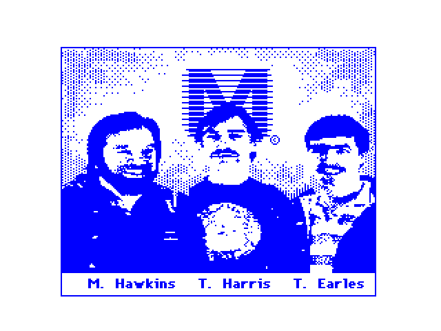

I attach its easter egg the programmers could have got into a lot of trouble for the added cost by marketing but at least it shows they had the same capability of gameboy cameras 🤣
    3.05 KiB
    513 views
    coco 3 easter egg
