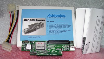

Reply 20 of 31, by Unknown_K
I have some of those, but I prefer the ones with 68 pin interface instead of 50 pin SCSI.
304.79 KiB
589 views
Reply 21 of 31, by feipoa
I don't understand the prices of these ACARDs. Couldn't you just buy a used SCSI HDD for a lot less?
Reply 22 of 31, by Unknown_K
They are ATAPI ONLY (that model anyway) so hard drives are not supported. The adapter lets you use a more modern IDE based tape, removable media, or optical drive on an old SCSI bus.
