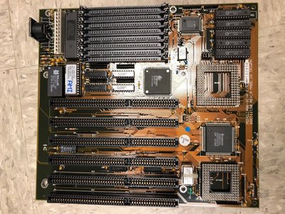

I want to build a 486 computer using only ISA cards.
I purchased this NEW old Stock motherboard.
I think it only supports 5v CPU's
So I can use a
486dx-33
486dx-50
486dx-66
These are the Socket-3 CPU's I have on hand.
What ram should I use for best performance and at what speed ?
EDO or Fast page ?
What speed ?
Also it has -20 cache modules installed. Looks like 128kb.
Is this okay ?
I have ISA controller, SVGA graphics card and Sound blaster 16/AWE64 or Yamaha or Media Vision with Yamaha OPL support card.
Network 3com 3c509. I can add multiple sound cards for OPL support.
What would you recommend ?

Reply 3 of 36, by amadeus777999
Go with the DX2-66 to have at least some headroom processor wise.
Since you're using a busspeed of 33 mhz, 20ns sram should be fast enough, but as always - testing is necessary. FPM vs EDO is more of an "economy" thing as former is often easier to get. You're board seems to support 30 pin simms which may automatically render EDO modules most likely a non option.
Regarding the tag ram - you're most likely stuck with 128 a 4 x 32K due to it being an old board(manual knows more) so your 32k tag is more than enough(a 16K tag "supports" up to 512K cache).
What are you using that machine for?

Reply 7 of 36, by jesolo
Expect the battery in that Dallas RTC (DS1287) to be flat (dates from 1992, week 18 😀), which means you'll constantly loose CMOS (BIOS) settings if switched off for extended periods.
You can either:
1.) find a suitable replacement on eBay (make sure the year of manufacture is fairly recent) or,
2.) see if your motherboard has an external battery connector (doesn't appear to have) or,
3.) go the mod route by using a dremel (refer http://pc-restorer.com/replacing-cmos-batteries-in-old-pcs/).
However, I agree that EDO RAM will mostly likely not work on this motherboard.

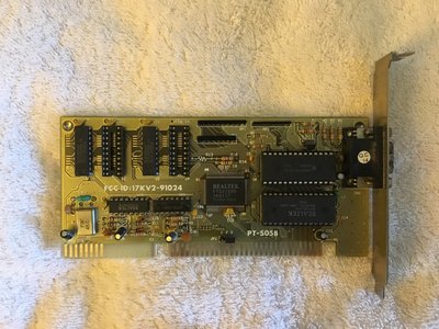

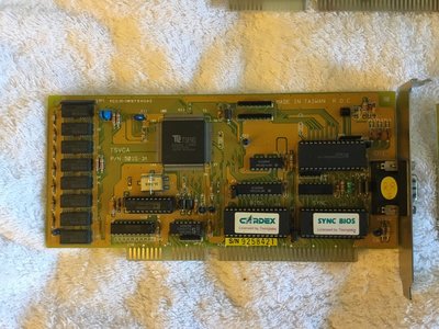

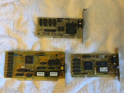

Reply 11 of 36, by Intel486dx33

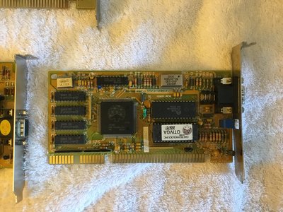

Here are the Graphics cards I have to choose from.
Which should I choose ?
I don't even know the specs of them.
The Oak Tech graphics cards was my original card from my first computer. ( 486dx-33 ).
    1.55 MiB
    1244 views
    1.52 MiB
    1244 views
    1.6 MiB
    1244 views
    1.59 MiB
    1244 views

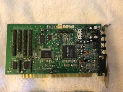

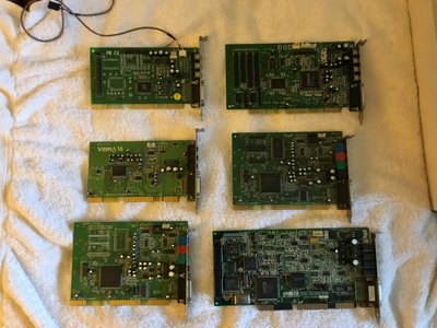

Reply 12 of 36, by Intel486dx33

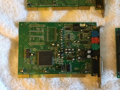

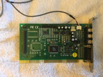

These are the Sound Cards I have.
Which ones should I use ?
Some also have a Yamaha OPL chip.
    1.54 MiB
    1216 views
    1.73 MiB
    1216 views
    1.48 MiB
    1216 views
    1.46 MiB
    1216 views
    1.59 MiB
    1216 views
Reply 13 of 36, by chinny22
To start with I would just go with the AWE64. Easy to setup and will support pretty much anything from Adlib, Sound blaster, AWE.
Once the PC has been running for a while you can try adding true OPL chip and seeing if the adlib games sound better.
CD-ROM, slow and steady is the answer.
A 486 cant keep up with faster drives which casues the drive to constantly spin up and down
a slower drive will just keep spinning at a slow steady rate.
But I wouldn't wast money trying to find say a 12x I cant remember the name but their is a utility that can set a faster drive to slower rate

Try to use 8 MB RAM (8x 1 MB). (30 pin, 70 ns, FPM). I don't think there are 30 pin EDO SIMMs.
A DX2/66 should be fine.
Take the ET4000 graphics card.
Reply 15 of 36, by dondiego
There were no 30 pin EDO modules and 72 pin ones would not work.
You can install either 4 or 8 modules, there are two memory banks there.
The tseng is the fastest card and the realtek the slowest by far. The tseng is really the only good card there.
About the cpu the dx2-66 is faster than the dx2-50 as expected.

Audio ? Take a look at that Crystal card it has build in Yamaha OPL. I also have a Media Vision card with built in Yamaha OPL.

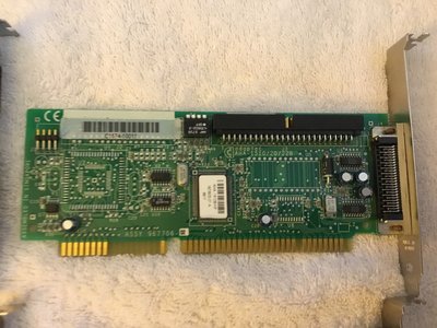

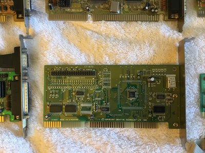

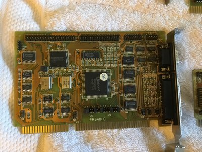

What about these controller cards ?
Which is bests ?
    1.65 MiB
    1177 views
    1.71 MiB
    1177 views
    1.66 MiB
    1177 views
    1.69 MiB
    1177 views
    1.43 MiB
    1177 views

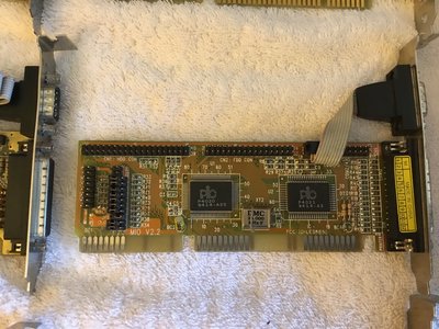

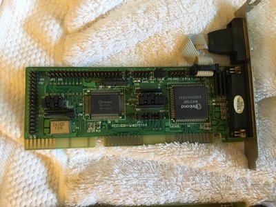

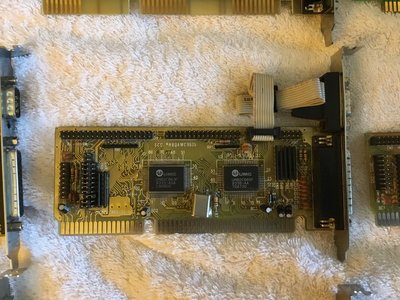

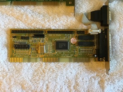

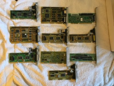

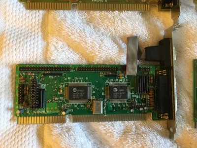

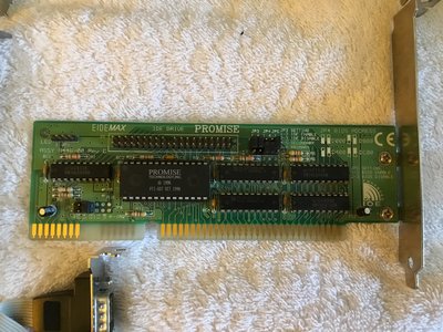

Reply 17 of 36, by Intel486dx33
More cards
    1.49 MiB
    1177 views
    1.6 MiB
    1177 views
    1.44 MiB
    1177 views
    1.55 MiB
    1177 views
    1.55 MiB
    1177 views
