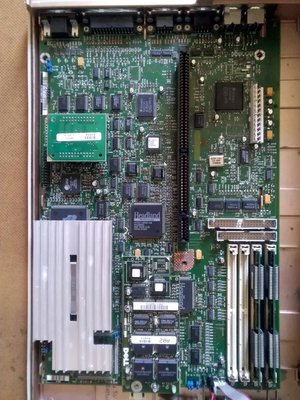

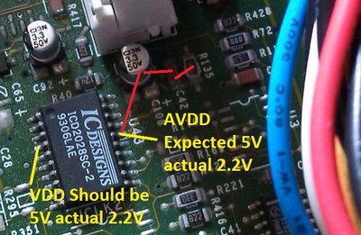

Reply 6 of 20, by gca
Thanks for the offer sirlemonhead, my problem appears to lay with the RTC power chain.
Tracking it back as best I can I get this (also see rtc-power-chain.jpg).
AVDD (pin 16 on rtc) -> C108 -> C42 -> R135
These should be running at 5V I think (based on rtc ic data sheet that indicates that AVDD is a 5V pin) but all I am getting is 2.2V. No idea where it goes from R135 as this is as far as I could trace it with a continuity meter (you may have better luck).
VDD (pin 4 on rtc) should be running at 5V but its getting 2.2V like AVDD so, maybe they share a common power source? I don't know I couldn't trace it.
Noticed that C87 (up by the motherboard power connectors) is giving 0V output so it might be a good idea to give that a check to see what you get. No idea if its related to this problem or not.
Also attached the RTC data sheet if thats any help.
And it doesn't make any difference if the rtc battery is installed or not, either way the voltages are way lower than expected.
PSU voltages are fine, I tried the PSU in another machine and everything worked as expected so that isn't the problem either.
Thanks in advance for the help.

Reply 7 of 20, by sirlemonhead
I'll try get to this as soon as possible...
Not to do the typical "It's old! CHANGE THE CAPACITORS!" thing, but I do notice the solder joints around the SMD caps on my board are really dull looking, and yours appear to be the same... Are they leaking do you think?
Reply 8 of 20, by gca

Reply 9 of 20, by sirlemonhead
So... seems my board is different!
I don't have the same RTC chip, and where yours is, is unpopulated on my board. I'm using the spot right beside it on the board, which has an avafem av9155 chip. It's getting 5v on it's VCC pin.
The capacitor and resistor you show in your photo is not populated on my board.
C87 also gives 0v on my board.
I have some bad photos I can upload later if they'd be any use 😀

Reply 11 of 20, by gca
Strange, esp as they are the same model. I'll get a photo of my board tomorrow and post it then we can see just how much they differ. I assume they changed the design at some point in the models life and we have different versions.
Semi relieved that C87 is 0v on both, so I assume I can rule that out as being relevant to the problems I'm having.
Shame I can't find a boardview anywhere (machine is probably too old for one ever to have existed) that would solve so many problems.

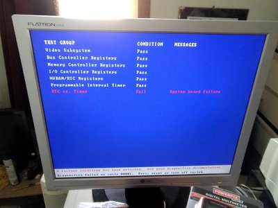

Reply 12 of 20, by gca
I had a few moments and got a photo of the board in my machine to compare to yours. And I re-checked the nameplate in case I misread it to confirm it is most definitely a 466/L.
Two notes on mine, I have the VRAM and L2 cache upgrades which explains the daughter boards above and to the right of the processor respectively. Both of which were removed during troubleshooting so we can rule them out as the culprits.
Also found the photo I took of the on board diagnostic results. Still have no clue how I got this running (maybe automatic, if so why hasn't it shown up again?) which shows something is very wrong on the timing front.

Reply 13 of 20, by sirlemonhead
Cool! I don't have the cache upgrade for mine. Did yours always come with it?
I need to borrow a better camera before I try take more photos as mine aren't coming out great - I have quite an old phone. Will get back to you..
