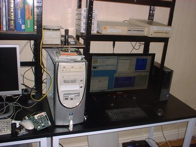

So I have built a new section for Retro work ..
This is a dedicated area consisting of an Optiplex 99o running Win7
The dual drive Kryoflux unit I built ..which will accept 5.25" and 3.5" floppies.
A 1541 Commodore drive connected to the Optiplex via usb using a miniXUM interface ..
The Kryflux drive is also USB

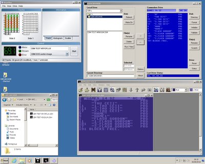

Software running on the Optiplex is DTC for Kryflux
OPENCBM and CBMTxfer
DirMaster to open CBM .d64 directories/images
Winimage to open PC floppy images
So far anyway..
With this setup I can image most Floppies ..
The 1541 specifically for Commodore disks ..but Kryoflux can also do this ..
See the Archive for the 2x Test .D64 images in the screen grab.

Here are a couple of pics ..
