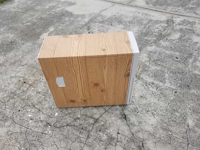

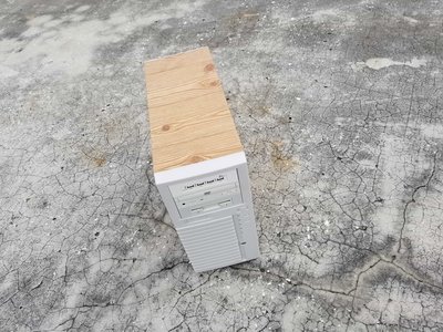

Reply 2 of 4, by Demonslayer2103
I also used a Chenbro SR209 for retro build I like that one a lot better but I never tried the one your talking about here are some picture. Note I put woodgrain on it

Reply 3 of 4, by W Gruffydd
Demonslayer2103 wrote:
I also used a Chenbro SR209 for retro build I like that one a lot better but I never tried the one your talking about here are s […]
The SR209 is another retro-looking option that is available for the same price as the SR20503, yet there appear to be key differences. On one hand, bottom-intake PSUs are not blocked; this alone may make the SR209 worth getting over the SR20503. One the other hand, if the card keeper bracket cannot be removed and the bottom fan cannot be mounted directly to the chassis, the front intake of the SR209 will be much more restrictive. As for the bezel, I like the look, although I find the lack of dedicated 3.5" bays less retro for '98 builds, and the two LAN LED indicators reveal it a server, if you are going for a desktop look.
