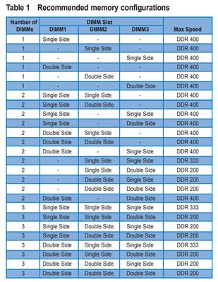

Reply 3 of 4, by appiah4
I'm going to take a wild chance and say all four DDR sticks I tried in these motherboards were faulty to begin with, so I am going to order two more sticks of 1GB DDR400 for this build. Another part of me is still worried that there is a strange RAM density compatibility issue here.. I've read threads dating back to 2004-2005 that say things like double sided DDR sticks are recognized as two banks and two double sided sticks won't run at 400MHz etc? This conflicts directly with the RAM configuration information in the manual:
116.44 KiB
501 views
Regardless, I'm going with 1GB Kingston Value Ram DDR400 sticks.. Any other suggestions?
