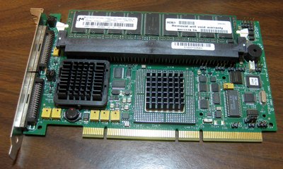

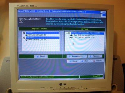

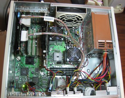

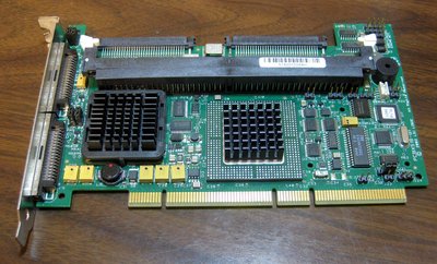

The question is largely theoretical. I'm in the process of setting up a two Ultra320, 146 GB hard drives using a PCI-X LSI MegaRAID 320-2 with 256 MB cache. It has two SCSI channels. Is there any theoretical performance benefit in connecting each hard drive to separate channels on the host card, that is, opposed to connecting each hard drives to the same channel if a) using a RAID 0 (stripe) setup or b) using a RAID 1 (mirror) setup? Second question is what stress tests can I use to compare these conditions?
Because people like photos,
