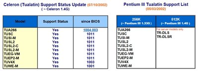

Reply 2 of 3, by PC Hoarder Patrol
FWIW, these old lists from ASUS suggest slightly different support
98.51 KiB
223 views
http://web.archive.org/web/20041022001910/htt … rontualatin.htm
http://web.archive.org/web/20041022002909/htt … /p3tualatin.htm
Reply 3 of 3, by Baoran
Thanks. I always thought they combined both user tested and officially supported in that site because in the past they pretty much matched what manufacturer had said on their site.
