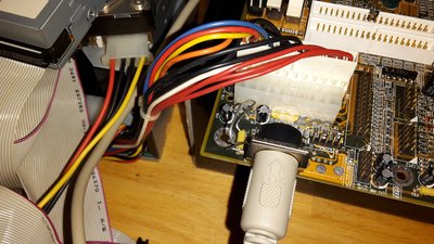

Hello everyone! I have a SS7 motherboard (Lucky Star 5mvp3) and I'm having keyboard issues. The KB lights up like it should, but it is not picking up keystrokes at all (and I cant press Del. to enter BIOS or anything) I don't know what happened, all I did was move the computer. I now have the board stripped down to one stick of 128MB SDRAM, a Video card, and the keyboard attached, and nothing else. Could the keyboard controller died on me, since the KB appears to be getting power, but no keystroke "signals". I'm kinda at a loss. Oh yeah the KB is a PS/2 KB with an AT adapter (I've tried 3 different adapters but the issues persists). Is there a way to test the port for signal/power etc??

I've also had that issue in the past where certain mobo/keyboard combos did not work, but I've been using this keyboard on this machine for a while, so the very first thing that crossed my mind was "Bad Keyboard". I tried the suspect keyboard on another computer and it worked. I used the other computer's keyboard on the suspect computer just now as per your suggestion and it did not work 🙁 I SO had my fingers crossed.
The keyboard fuse on the motherboard crossed my mind as well but I'm not sure the keyboard(s) would light up (which they do) if the fuse was bad. So the last thing I thought of was maaaaaybe when I removed the keyboard connector from the machine when moving it loosened/wore out the signal receptacle of the DIN-5 connector on the motherboard (I'm reaching at this point 🤣) ORRRR the IO chip has bit the big one 🙁
I too could boot to Windows 98se w/o the keyboard working, but now I can't even do that because I'm stuck at POST with a checksum error because I reset the BIOS, thinking that might help. 🤣 what a PITA

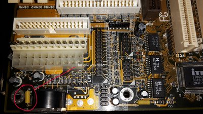

Reply 4 of 9, by WileECoyote
Here is a pic of the Fuse that blew and my ghetto temp fix to verify. Now the question is... where do I find said fuse??? I think it reads 3Amp

    Pic of Ghetto TEMPORARY fix for verification lol

    218 views
    Pic of suspect resister
