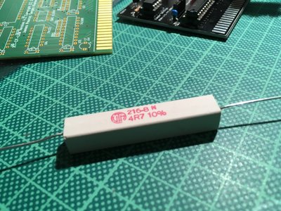

So some people here mention that one should put a ballast resistor on the ATX power supplies, when powering AT machines.
I wonder how sensible this is, and if it is really needed. My 286 is currently running happily, but I am worried I might damage the ATX PSU or my mainboard due to this...?
Here is a blog post describing installing a 4.7 Ohm resistor for usage in a 3D printer with ATX PSU:
https://brazenartifice.wordpress.com/2011/12/ … 12v-regulation/
I have a 4.7 Ohm 10W resistor that I could use:
1.03 MiB
668 views
But I wonder: is it necessary? What are the disadvantages, apart from the resistor running hot?

Well one disadvantage is that it will draw a bit over 1 amp from the 5V line, and machines from that era tended to run primarily off the 5V line; 1 amp in the resistor means 1 amp less for the computer. Make sure that the PS can still deliver the required amps on 5V with the resistor on.

These resistors are only ever needed to act as a load for a PSU where a particular rail is not used so it could operate propely. Some PSUs will not regulate the voltages correctly when a rail is unloaded.
In case of that 286 machine this is not a problem whatsoever, that resistor will not do more than waste power and increase temps in the machine.
