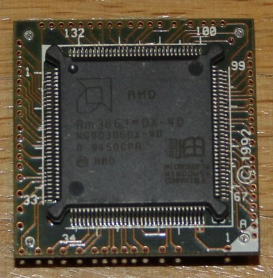

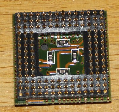

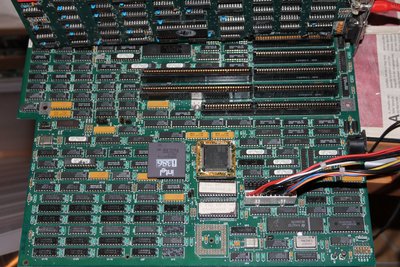

Took the opportunity and tested this JATON 386-DX-40 CPU module I got some months ago...
190.74 KiB
1089 views
255.62 KiB
1089 views
...in a really ancient 386 board:
1.79 MiB
1089 views
Powers on without problems.

Woow man! That's great both for the thing itself and for the data provided!
THANKS!
Enjoy your beefed-up very ancient 386 board! 😁

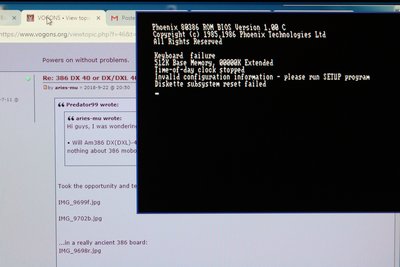

Before disassembling again...
1.74 MiB
1078 views
1.86 MiB
1078 views
...Am386 DX/DXL-40 also no problem 😀

Wow! It seems to me that those older systems were more sturdy, flexible, and less pain with jumpers and stuff.
It'd be interesting to assess if it is running at 40 MHz or being downclocked!
