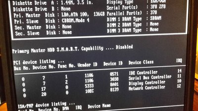

Hello fellow retro hardware enthusiasts! I am having issues getting my DFI P5BV3+ Rev.B2 board to recognize my 120GB Seagate Barracuda 7200.7 IDE HDD. It will work with the 32GB jumper on but the BIOS will not recognize the drive w/o that jumper. I downloaded a few BIOS updates that stated they patched for "upto 128GB HDD support" but I haven't been able to get it to work. I've tried BIOS update from;

Anyway, I'm not sure if I'm supposed to do something else but to summarize what i've done
1: Installed drive w/o 32gb jumper..... wouldn't recognize HDD
2: Added 32GB Jumper.... Hard Drive recognized (32GB of course)
3: downloaded "32gb enabled" BIOS from "Wimbios.com"..... BIOS worked but still only recognizes drive with 32gb jumper
4: Tried another BIOS from "bios-modes.com"...... same results
5: Found the thread on here on a past build and downloaded the BIOS he used...... The machine froze at POST during Drive(s) auto detection and in BIOS when trying to auto detect drives
6: reverted back to thw Wimbios.com BIOS.... of course, still no 120GB HDD detection, only 32gb with the jumper on
Any help would be appreciated as I would really prefer to have access to the full drive
Oh I have been using just a standard 40 pin IDE cable with the HDD as master and a 24x CD-rom drive as slave.
Many thanks in advanced,
Wile E. Coyote

Reply 2 of 8, by WileECoyote
Thanks bjwil1991! I tried clearing the CMOS via jumper, that didn't help so I tried reflashing with the /cc switch, still the same 🙁
So I decided to try uniflash instead of awdflash but that didn't help either.
Here's a pic of what I get when i try to boot after flashing w/o the 32gb limit jumper installed
The fact that it says ata 100 and 136GB is intriguing...

Reply 3 of 8, by SW-SSG
Perhaps try an 80-wire IDE cable... technically the 40-wire ones are good only for up to ATA-33. (Some MBs/BIOSes will detect this at POST and recommend replacing the cable, but perhaps your board doesn't do this).
Reply 4 of 8, by WileECoyote
That's what is confusing to me. The board only support up to DMA33. I'll try the 80-pin anyways, because why not 🤣. Thank you for your suggestion.
Reply 5 of 8, by SW-SSG
Oh, I missed that... bah. Still worth a try anyway, and it's interesting indeed that the BIOS displays "ATA 100" despite not supporting it...
Reply 6 of 8, by PC Hoarder Patrol
@WileECoyote, maybe a longshot but have you tried any IDE drive other than the 120GB Seagate Barracuda 7200.7 - these have previously reported compatibility issues with some controllers.

Reply 7 of 8, by WileECoyote
Also, think the CPU cooler in the other link is a Cooler Master HHC-001
Awesome, thank you! Now I just need to find one of those CM HHC-001 haha. I have an 80gb WD I'll give it a shot.
Reply 8 of 8, by zyga64
SW-SSG wrote:
There are tools from hard drive manufacturers to limit max UDMA mode supported by drive.
Some motherboards tries to set drive for max supported mode, while it doesn't support it by itself. This may cause problems.
Try to find tool for your harddrive.
BTW. "32GB patch" means that drive support drives above 32GB (up to 80GB). You may try Bios Patcher from www.rom.by to overcome 80GB limitation.
