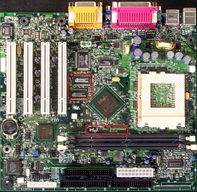

Yesterday, I acquired an unknown Gateway micro-ATX motherboard from ebay. I bought it because of the CPU that came with it, a Pentium 3 1.1GHz 100MHz FSB SL5QW, that I am going to use to upgrade another retro system I have. I just finished cleaning it and the CPU, replacing the CMOS battery, throwing in some RAM, hooking up a PS/2 keyboard and monitor, connecting it to a PSU, and BAM!, it all works!
Any who, now for the reason of this post. You see, being a person who likes to make sure things are up-to-date, I naturally looked online to see if I could find the latest BIOS for the board and see if I should update it or not. Typing in the string "WL810E" (found on the back of the motherboard, shown below), brought me to this Intel support page for the D810E2CA3 motherboard. However, while both that board and this one are similar, they are not the same apparently (not talking about my exact motherboard, but close enough).
Now, upon further research, I found this post. Apparently the guy has the same motherboard, which is called the Intel Bryant R2, and it was from a Gateway Essentials 566c. Using the Wayback Machine to view one of the older pages linked by the people responding in the post, it would seem I have the latest BIOS, although the supposed BIOS flash executable in question only discloses the actual BIOS version to the "P06" part, so I cannot say if this is the same exact BIOS I have on my motherboard or not. Also, since I don't know the exact machine my motherboard came out of, I am unable to find "support" for it. And I could be wrong, but it also seems that Gateway drops support for older products such as these, no?

Reply 1 of 5, by PC Hoarder Patrol
As far as I can find you already have the latest bios for the board (P06)
https://www.wimsbios.com/forum/what-motherboa … nual-t4576.html
The board itself seems to be based on an OEM of the Intel Willow Springs 2 (WL810E), but I couldn't see any links on the live Intel site so here's a copy of the manual.

Reply 2 of 5, by ultra_code
PC Hoarder Patrol wrote:
As far as I can find you already have the latest bios for the board (P06) […]
A12504-001.pdf
Yep, that's my board alright. The manual which you provided (thanks 😀 ) more accurately depicts the board than the manual for the D810E2CA3 does.
As for the BIOS, that's also good news. Less work for me.

Reply 5 of 5, by PC Hoarder Patrol
Generally the bios OEM code mismatch would stop you doing any damage beyond a default reset of the existing bios, although you can sometimes mod this code in an Intel bios to allow it to flash to an OEM board

For comparison, here's a pic of the Intel-branded version of your board (complete with the 4MB optional display cache)
