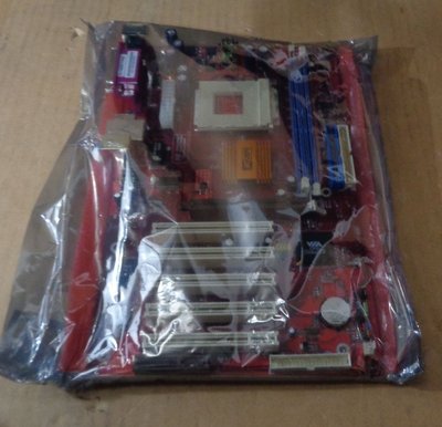

Reply 8 of 25, by Intel486dx33
SpectriaForce wrote:
You can even build and configure a DOS compatible game pc using a cheap S462 motherboard (or slot 1/S370/S478) with a BIOS that allows you to disable the caches and lower the CPU clock speed:
https://youtu.be/K5vYD0JMD_A
Lots of people on this forum keep thinking in their narrow boxes (with their expensive ISA sound cards and motherboards), but with minor tweaks more recent hardware can be turned into something that is usable for DOS gaming.
I am going to build some of these. This sounds like a great idea.
I am tired of working with old electronics most of which don't work.
Building one of these should lasts 5 years or more.
You can build one for about $100
Got a NEW motherboard for $30
    226.32 KiB
    1634 views
