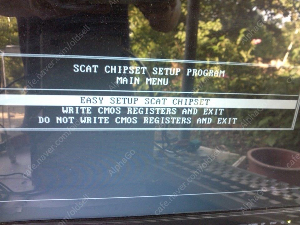

I have the motherboard from the title (Biostar MB-1212C, 286, SCAT chipset). It has 1M onboard RAM (2 banks of 512K, populated with 44256 chips) and also has 4 SIPP sockets for max 4MB.
It works fine with the onboard RAM. But if I remove the onboard chips and add 2MB or 4MB to the SIPP sockets, it doesn't boot anymore. If I leave the onboard chips and add SIPP memory, it will recognize the onboard memory but nothing else. If I add a memory card, configured to add extended memory from 1MB up, it will not recognize it.
I wonder if it's a BIOS problem, as it has a much different BIOS from what I found online, such as the pictures here: https://www.worthpoint.com/worthopedia/biosta … -286-1846660577
My BIOS setup looks like this:
And from there it's a series of small popup boxes. They allow me to set clock speeds for DMA, bus etc as well as wait states for the DMA and onboard RAM, but not much else.
I've looked online for alternative BIOS files for this motherboard but have found none. Does anyone here have a BIOS for this that I could try? I have EPROMS and a programmer.
Can I try BIOS files from another motherboard that uses the same chipset I wonder. I have found here http://chukaev.ru54.com/bios_en.htm file 2ctc001.zip which is from a "GW-286CT GEAR" which has the same C&T F82C235 SCAT chip.

FWIW I have found a partial solution. It was a composite of several issues:
1. Some of the memory cards I was using I had a poor understanding of the switch setting (due to the manual being poorly written)
2. This motherboard requires parity enabled both on the motherboard and the extended memory cards in order to recognize RAM on them. I had initially parity switched off in the BIOS, but after I switched it on I started making progress.
One problem remains: It still doesn't work with SIPP memory. Even with parity switched on (and of course using parity modules) it still won't boot. It only boots if the DIP sockets are populated, and the SIPP sockets are not.
