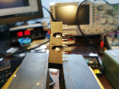

I bought a new real time clock Dallas DS12887A+ and when I got it in the mail all but 3 of the pins were bent as the packaging was just some bubble wrap in an anti static bag usually IC's have some polystyrene foam to stop the pins getting bent so I contacted the place I got it and they are sending me another one free of charge, I was able to straighten the pins but it does not work so im hoping the RTC has a dead battery and its not a fault with my motherboard, I have looked for the pin out and found this page:

On the DS12887A+ the internal battery voltage (Vbat) is not accessible on any pin; you cannot measure it directly. If the chip is "NOS" there's a good chance that the internal battery is long dead. There are guides on how to grind the package and expose the internal battery leads which allows you to connect an external battery to it.

Reply 2 of 2, by realoldguy23
This is where the battery pins are:

ODIN 12C887
I think you can get these for around 10€ brand new, at least in Germany: https://www.reichelt.de/uhren-kal-ic-real-tim … l?&trstct=pos_0 Maxim still seems to make them. But I went for the "tinker route" and it worked. 😀
