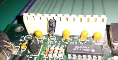

I found a 286 motherboard, equipped with an Intel 286-10Mhz CPU and a 287 co-processor.
I hooked it to an ATX power supply with an ATX to AT converter (this one: https://www.ebay.com.au/itm/4-PCS-ATX-20-PIN- … E-/261635278711), connected the speaker, an ISA VGA card and booted it.
It booted, beeped, and the display started showing text! It was in the middle of memory check when the PSU turned off.

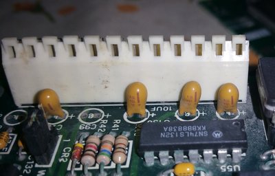

I tried turning it on again but the PSU would immediately turn off again. I tried several other PSUs but the result was the same. I managed to detect that the 4th pin (-12V) on the motherboard is shorted to ground. I traced the.. umm.. traces, and found that the capacitor directly adjacent to the -12 pin is shorting. I de-soldered the capacitor and was able to find and solder a matching capacitor (10uF. I removed it from some cheapo modem that I had in my throw bin).

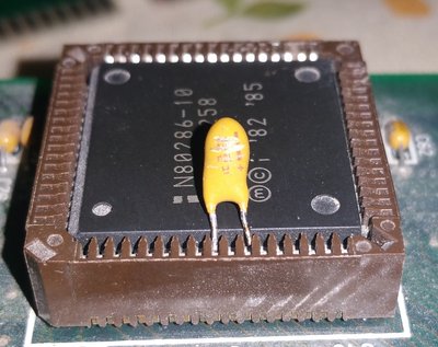

Now the PSU keeps running, but the computer does not boot anymore. The CPUs get warm.. even a bit hot. Not sure if it is normal.
But I get no beep, and no display.
I de-soldered the battery and cleaned the area a bit with alcohol.
I tried taking the 287 out but it didn't help.
Any Ideas?

Check all tantalum capacitors, if one go bad, all the other ones are likely to go bad as well. Tantalum capacitors fail short so this should be easy to find out if any other cap is doing that as well (and should should even do that for those that don't yet as they're likely to fail soon)
Reply 2 of 18, by bjwil1991
Make sure you're using the right cap since some of them are more than 16V or less than 16V. In fact, recap the whole motherboard since that'll be the issue right there. Think of the tantalum capacitors as the older Christmas lights: one light goes out they all go out, and finding that one bulb can take hours.

I can't say that I checked ALL of the 100+ capacitors on the board, but so far I wasn't able to find anymore that are short. I looked at prices for tantalum capacitors, and replacing all of them would be quite expansive. Its possible to use electrolytic capacitors instead, right?

I see green stuff on your close-up photo. Perhaps a trace was corroded, barely making contact and it finally gave up when you worked on the board to change the capacitors.
The usual drill - vinegar, water, alcohol (isopropyl for the board, beer for you), then carefully check that area. You might also need to look under some of the ICs and sockets/connectors...

I have to agree with Quicknick, your board is really "dirty". There is a high probability that especially the 3 big PLCC sockets give bad contacs to their chips.
Some time ago I refurbished a Amiga 500 that was in a quite similar condition dirt-wise. It worked for some time. One day it didn't turn on anymore showing just a black screen. I did all the easy things of thoroughly cleaning the DIL IC's pins and sockets, even replacing some of them. Finally I took a closer look at the Fat Agnus chip and its PLCC socket. I first needed to buy a PLCC chip remover tool, but this was worth it. The contacts of the PLCC socket were completely corroded and they were stuck and didn't apply spring pressure on the contacts of the Fat Agnus chip.
I replaced the PLCC socket altogether, which was easy given that the A500 has only a double sided board and I have the soldering equipement for such things. After this the A500 started up without any problems.

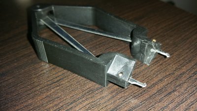

I think desoldering and replacing the PLCC sockets is not an option for such a hard-to-solder multi layer board. But you should get a PLCC tool, remove the chips, and clean the contacts and the pins thoroughly.

I actually have such tool, but I wasn't able to remove the CPU with it. The prongs do not seem to fit the notches in the CPU socket. But I'll give it another try when I'm home.

I had the same problem, the chip was sitting very tight in the socket. I think the corrosion had made i stick. Maybe you can try to use some contact cleaner to loosen the corroded contacts. Anyway, you should be very careful, these PLCC sockets are said to be easily broken apart. And as I said, you don't want to replace them on a multi layer board even if you have the right soldering tools. These boards have a very high thermal capacity due to their power plane layers.

Also take care with the PLCC extractor, as the chips are usually very stuck. On trying to remove a PLCC 84-pin chip from a 286 board one of the prongs destroyed the corner of the chip, I had to tear down the socket piece by piece (and replace it with a new one) to extract the chip.
Reply 11 of 18, by anetanel
I think that my tool is not appropriate for those sockets. Its pins are too thick and they do not get under the chip. I was able to remove all the chips with a tiny screwdriver though.

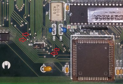

root42 wrote:
Does the board have any test points by any chance?
I think so. you mean the small contacts that go to each component (picture attached)? How do I use them?

- Did you check for broken/corroded traces near the battery?
If the board proves to be un-repairable and you decide to scrap it, please contact me.
All traces seems fine as far as I can tell. I also replaced the battery with a CR2032 socket.
