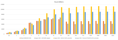

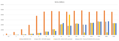

I was recently considering alternatives to replace a dying hard disk on my PIII/win98 PC. Theory is one thing but I thought since I had all the parts available why not also get some numbers.
So although the comparison doesn't include a CF card, since PATA->SATA adapters were brought into the discussion I believe this has a place here with some interesting results.
My intention was to compare a faster-than-period-correct mechanical 80GB IDE HDD against a today's (or better yesterday's) SATAIII 64GB SSD. So I benchmarked using ATTO Disk Benchmark, but also used the system for a week or so to get the real feel (very important!)
-The IDE HDD
-The SSD with a PATA->SATA adapter
-The SSD on the frowned upon Silicon Image Sil311x PCI SATA controller
-The SSD on the praised Promise PCI SATA controller
41.24 KiB
853 views
31.82 KiB
853 views
My bullet points:
-A good IDE hard disk is much better than I thought it would be. See the writes? Just how and why?
-The Silicon Image controller excels in reads but chokes in writes, and apart from the chart this is also perceivable when actually using the system. Feels OK until you throw a lot to it and experience the occasional stutter.
-I promise, the Promise is the way to go if you're after the best. Feels fast and it is fast and consistent.
-Wow those PATA->SATA adapters... Seriously, even if I ended up using the Promise controller for this specific win98 PC, those adapters are gold. Nice performance, no hiccups whatsoever, no drivers needed, they just work more than OK. Yeah transfer rate figures may suggest otherwise, but for real use an SSD with a PATA->SATA adapter is faster and more reliable that anything you ever had/need.
Hope this helps someone...
Reply 8 of 9, by konc
mrau wrote:
whats the x axis showing? it looks a bit like You were working with an almost empty drive or did not disable write caches
Oh sorry, it's ATTO's benchmark different size chunks. So it's the performance when reading-writing 8K/16K/etc
