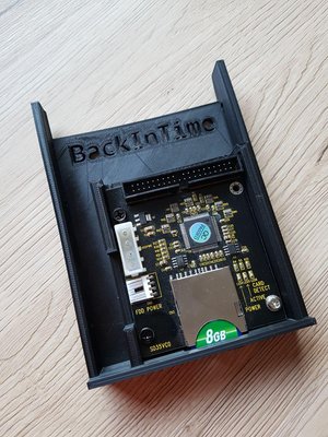

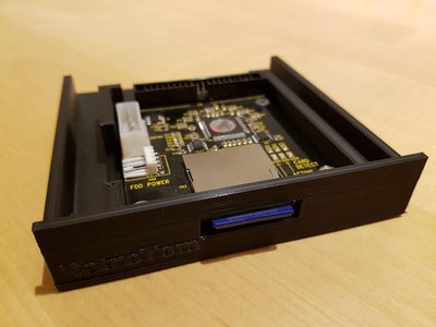

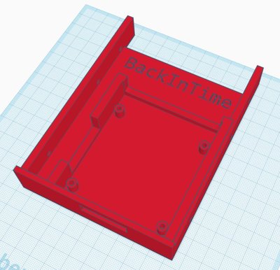

I'm using both kind of Adapters, IDE->CF with a braket and IDE->SD like it is linked on the first page of this thread (or as you can see on my picture below). But as you already stated, the prices for CF cards are rising, while the prices for SD cards are quiet low these days. So I bought more of the IDE-SD adapters for my retro-rigs. But as they were only loose PCBs I already had a short-circuit because I wasn't sure where to put this thing... and while moving the runing PC around it fell on the floor of the computercase... stopped working obviously 😉

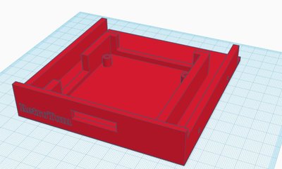

So I made a small housing with my 3D printer, so that I could lay it anywhere into the case without the danger of another short circuit. But now I still have to have the case open or have to open it for switching the SD cards. So I've designed a 3.5" housing for this thing. I'll have to print a first example this night and test if all measurements are good, but if it is, I'll upload it to thingiverse so that you can print it out for yourself if you want to use this kind of IDE->SD adapters in your rig.

Design of the 3.5" housing
93.87 KiB
853 views
Simple housing for laying in the case

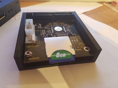

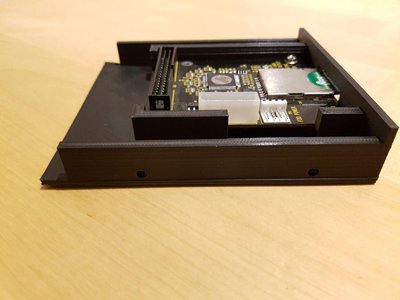

I'm honored, but my designing skills are only rudimentary. I hope I can help some of you. First prototype was printed last night. I think I had some missreadings in the measuring. The pcb fits, the thickness of the front-plate is good for the push/pull mechanism of the sd card, but the thing is about 1cm to wide... so it's another night of printing for another run.
93.32 KiB
834 views
Too wide for the drive slot...
89.25 KiB
834 views
First Prototype - failed

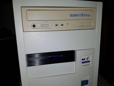

First thing is ready and build in. There might be some problems in very small computer cases. For those cases I might add another version where the pcb is mounted a few millimeters lower to provide more space for cables.
https://www.thingiverse.com/thing:3232293
Try to print it, I would appreciate any kind of message if it works or if anything could be improved.
