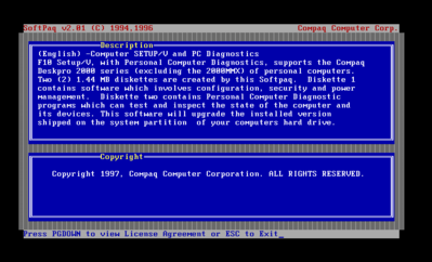

edit: I'm gonna try and see what happens in my windows98 Virtual Machine
edit2: yeah these are probably 16bit executables or something.... I have to leave for work very soon, so you need someone to grab these files in a VM Or whatever they can to see if you can make setup disk images or whatever you need, out of them.
I ran the year 2000 one and it looked like it ran in a command prompt
edit3: Someone with a capable machine needs to download SP4711 or whichever is preffered for whatever OS (not sure if there are differences) which is the utility listed as making the setup disks (under the MS-DOS OS selection at least)
then run it on a machine / setup that can create drive images.

setup initial screen

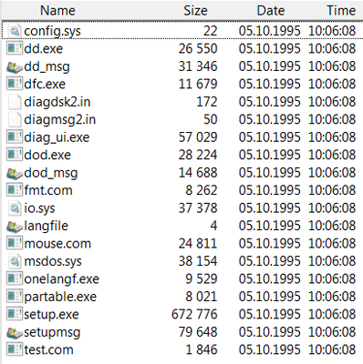

Ok. Try this. It was made by sp1363.exe in a virtual machine win98. I don't know if it's suitable for your rig.

It was made from sp0891.exe with util QRST

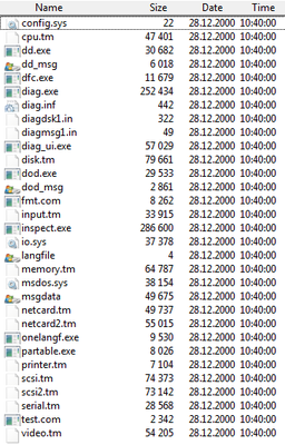

20.19 KiB
2471 views
sp16085.exe (made by QRST5)
30.33 KiB
