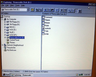

Were there ever NT 4.0 drivers for the LS-120 SuperDisk drives?
I have both a regular floppy and an LS-120 drive connected. For some reason, NT 4.0 turns my regular 3.5" floppy into a 5.25" and gives the SuperDisk a 3.5" B:\ floppy designation, which cannot be accessed. The SuperDisk can be accessed through G:\ as a Removable Disk. This is all kinda messy. Anyway to correct this?

Thanks for the links, however, I didn't see my particular problem listed in the FAQ. Seems like the drivers I'm finding are for the parallel port version. SuperDisk drivers should be built into SP5+ Anyone know how to correctly reassign A: to 3.5" and delete B:\ ? I didn't run into this issue with XP.

Can't you reassign the drive letters in Disk Management for the floppy drives, or does that only work for hard drives in there?

I only saw the option for the hard drives and cd-roms.
That's unfortunate. Do the Master/Slave settings for the disk drives appear correctly in the BIOS?
If not, you should check the cable and the jumper settings on the drives themselves.

I'm going to see what happens if I remove the ordinary floppy drive.
The BIOS sees it as secondary master. There is nothing else connected to the cable. It didn't work when connected as slave to the CD-ROM using an 80-pin cable, so I moved the CD-ROM and used a 40-pin cable.
