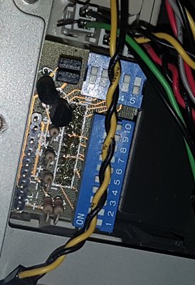

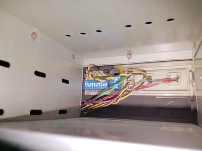

Does anyone know how to configure this kind of lcd case display?

Reply 1 of 18, by SW-SSG
Trial-and-error ought to work well enough, wouldn't you think?
Especially as this one has dip-switches; many of them stuck to motherboard-style jumper blocks.
Reply 2 of 18, by badmojo
Dip switches! How luxurious.
Yep you won't break anything, just toggle away until it displays what you want it to say. Hey that was quite poetic.
Reply 5 of 18, by Baoran
I did put a motherboard to the case and I got the turbo button and turbo led to work, but I don't know how to even get that lcd to even power up. Perhaps the wires coming from the turbo button are connected wrong or something?

Reply 9 of 18, by Baoran
badmojo wrote:
Can we get a better pic? I can't see the pins. Do any of them have a + / - ?
related:
CPU Clock Speed Diplay
I meant those 9 pins in line above the dip switches where those yellow and black wires are connected that come from the turbo switch. I don't know if those wires are correctly connected because they were like that when I got the case. There are some markings but they are hard to see because of the resistors. Below 2 leftmost pins it says P.L and below that there are + and - signs. 2 nest pins say T.L and below that - and + signs.

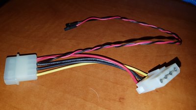

Reply 11 of 18, by Baoran
I went through my stuff and I found this:
1.8 MiB
648 views
Anyone knows which pins I can connect it to get power without breaking anything?

Reply 14 of 18, by PARKE
PL stands for Power Led and TL stands for Turbo Led - you can use these pins to feed the frontpanel leds instead of connecting them to your motherboard.
The next three pins are usually for connecting to the turbo switch.
And the last two pins are then (as was pointed out already) to connect to 5volt.
Reply 15 of 18, by Baoran
I took a risk. I connected the power to P.L + and - and I have power now on the lcd.
It seems very limited what numbers can be shown on the lcd though unfortunately when I tried the dip switches.
Reply 16 of 18, by Baoran
In the bank of 10 switches first 7 seems to just change segments of second digit when turbo is on and switches 8-10 seems to change first digit between 1,2 and 3.
Bank of 5 switches just seem to change non-turbo mode between numbers 0, 2, 4, 6, 8, 10, 12, 14, 16 and 18
So unfortunately the highest number for turbo on seems to be 39 and highest for non-turbo seems to be 18. Unless those extra pins at the top do something about that. The right jumper turns of the display for non-turbo and left turns of the display for turbo mode.
