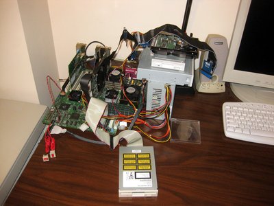

Anyone know how to create a bootable LS-120 SuperDisk? While my SuperDisk drive is OK to boot regular floppies, I am struggling with creating bootable media on LS-120 disks. I have images created of my personal ultimate boot diskette, but when I use WinImage to write the information to the 120 MB SuperDisk, it says that the current image format is not compatible with the disk drive. So how to create a bootable LS-120 disk?
In XP Pro, Windows Explorer, when you right-click the SuperDisk drive B:\ , and go to Format, the option to create a bootable diskette is greyed out.

I tried using the integrated bootable diskette writing features as part of a few bootable packages, however, they too complained. I was going to try clonezilla, but that images was over 120 MB. I was going to look for some USB-based ones, but then I tried something that worked.
I put the LS-120 into my 486, which is running Win95c. The option to "format + write system files" was not greyed out, so I used this. It took a long time, perhaps 10-15 minutes, but the LS-120 diskette is now bootable. I've begun creating my new ultimate boot diskette with this LS-120 disk. Unfortunately, DOOM_SW and QUAKE_SW don't want to run off the LS-120. Perhaps some other DOS startup file I'm missing which was not written to the disk? Wolfy runs though.
I'm using an internal IDE LS-120 drive.
Reply 4 of 10, by feipoa
C:\Quake_SW\quake
OMPT=: cannot open
For DOOM, it appears to be working today. Test system is a dual Tualatin 1.4 GHz, HE-SL chipset.

Update: Even using my regular 3.5" floppy diskette to boot, then navigating to C:\games\Quake_SW\quake.exe results in the same error. Quake only runs if I boot to DOS from the HDD directly. I'm guessing there are some files Quake is looking for which need to pre-load w/DOS? If so, which ones?

set the path variable
Oh yeah, that did it. I'm not used to having folders on my ultimate boot disk, so path was not set at all. Nice catch! Working now.
