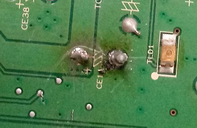

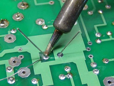

When you solder on new capacitors do you apply some flux first to the area so the solder will adhere better ?
Or do you just solder it dry ?
If so what type of flux do you use ?
I find that when I try to solder dry it does not adhere well to the PCB area and usually burns the PCB.
If I add some No-clean flux it adheres better and does not burn the PCB area.
I want to know what is the best type of flux to use ?
Also I add the solder to the iron tip and not to the capacitor PCB area.
Once I have the solder iron loaded with some solder I then just touch the PCB/capacitor leg and the solder flows on to make the bond between the capacitor leg and PCB.

Reply 1 of 10, by treeman
what you are doing is probably a technique better used for smd where u can't physically touch the pads because the capacitor or chip is on top so the flux is applied manually.
for through hole and bigger things I find it the easiest to apply some heat with the tip to the area you are soldering and touch the solder there direct, most solder has flux in it so as soon as the solder melts the flux activates and wets the area you are soldering bonding the wet solder.

I follow IPC guidance for soldering on circuit boards. (I'm IPC rework certified as well)
For proper soldering and rework, follow these documents:
IPC-J-STD-001
IPC-7711B
IPC-7721B

Reply 5 of 10, by Vipersan
The real issue replacing mobo electrolytic caps is getting the solder to flow ..
mainly because of the large ground and psu planes...
also consider these are multi layered boards so often have sandwiched traces on those hidden layers.
I use chipquik during the removal process which makes it easier to keep both solder points liquid at the same time..thus wiggling it out with a side to side motion doable.
But imo it is imortant to make sure your solering iron is of a high enough wattage to liquify the solder properly ...a low wattage iron cannot achieve this.
Other things you can do to help the process is quality flux ..and pre-warming the pcb ...thus helping your soldering iron do its job.

Reply 7 of 10, by jxalex
* I use only that flux which is already in solder. Both for removing old ones and soldering new ones I just add solder.
the same way I clean the holes -- to remove old solder, just adding MORE fresh solder becouse thats the way how to melt the solder in that multilayer PCBs.
Then just on occassion the solder wick cleans the holes when needed or just adding more solder to melt the solder and using the drill to clean the holes while solder is melted. THis way no burned PCBs.
All done with 50W soldering iron.
Just the solder with high lead content used for all these procedures.

Reply 8 of 10, by shock__
I'm basically doing the same as jxalex, except that I use a desoldering pump - be sure to use a _good_ one with a teflon tip and low kickback, otherwise you can enjoy your soldering iron chiseling away on the board. My personal recommendation would be the Soldapult SS350 (~20€)
Just make sure pins can be wiggled after sucking away the old solder, sometimes they get stuck to the outsides of the vias even tho they look free.
When unsoldering pins that are attached to ground/supply planes on multi layer boards (like electrolytic caps on pc motherboards usually) make sure to use a tip with decent thermal capacity, don't resist to ramp up the heat if required and expect for go for multiple 'suckings' to get the component unsoldered.
I usually only use wick for SMD or cleanup once through hole parts have been removed.
