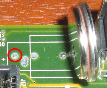

The attachment blob.jpg is no longer available
I could be wrong but it looks like something could have been soldered there^ at one point.
In any case, that "mount" seems a bit too fragile/precarious for most manufacturers... I've certainly never seen a board look like that from-factory.
Btw, there is a HOT-419 of similar colour, but with normal-looking battery holder and missing 3.3V regulator, pictured here.
Reply 4 of 9, by yawetaG
As the battery is spot-welded to it, it would take quite a bit of force to remove it by accident in a normal environment (recycling centers are not normal environments), especially with the keyboard socket right next to it.
Such holders are more commonplace in professional equipment, AFAIK.
Reply 5 of 9, by keropi
That battery is a rechargeable one, not what came originally with the mobo but it is a direct replacement for the classic barrel shaped ones.

Reply 7 of 9, by Murugan
AFAIK it's not a good idea to replace this with a non-rechargeable one.
Reply 8 of 9, by canthearu
If you want to replace this battery, cut it off and use J1 (next to keyboard connector) to install an external battery.
Reply 9 of 9, by Murugan
+1
