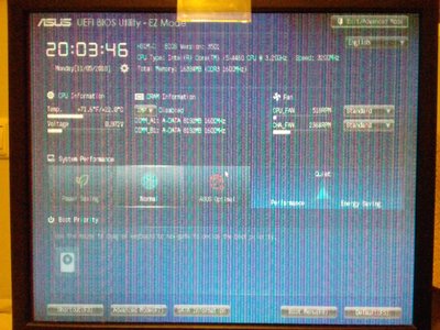

I recently bought a ATI Radeon X300 SE for like €3,50, but it doesn't seem to work. The image is distorted and vertical rainbow bars are shown across the screen, the text and images are perfectly identifiable though. I used the following setups to test the card; all different to verify that the card itself is the issue:

So far these minor fixes haven't made a difference. I noticed that the bottom of the SMD-capacitors are somewhat separated from the top shell, I don't know much about SMD-capacitors, but it didn't look very healthy to me. But even if the capacitors are bad, then it still shouldn't result in an issue like this, or does it? Correct me if I'm wrong please.
The seller already refunded my money, but even though I'm happy about that, I'd still like to fix the card and use it. If you guys have any ideas, please tell me! I'm looking forward to hearing from you soon,

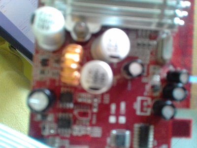

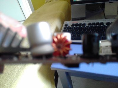

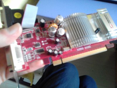

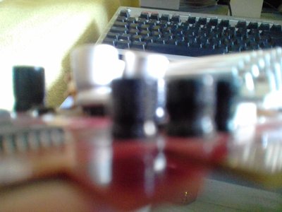

Reply 3 of 12, by Strahssis
Thank your for your reply! I made some pictures of the graphics card. I'm sorry for the bad image quality; my camera isn't very good. Please note that the black underneath the silver capacitors is not their shade; it's actually the black bottom of the capacitors. 😢
I will at least replace those three capacitors then later this week. 😀

Reply 4 of 12, by Vipersan
Oh yes indeed ..
assuming you have not lifted these caps ..and it has occurred naturally due to internal expansion of the electrolyte..
Then yes ..these tilted caps are prime suspects..

Reply 9 of 12, by The Sandman
The card itself looks like a dumper find. If you really want it, you can try to bake the naked card with the cooler removed in a stove for 10mins at about 110 degrees celcius. According to the pics I guess that the RAM-Modules got desolderd partly or have very poor conctact to the PCB due to heat problems. But be aware: even if you succeed, the card wont last very long after that.
