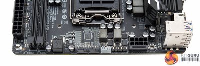

Reply 23 of 24, by FFXIhealer
To answer the original question, how do you tell a system that needs lots of 5V power from a system that needs lots of 12V power? Simple. Does your motherboard have this:
475.09 KiB
232 views
See that extra 8-pin CPU Power socket on the bottom right? That's an extra 12V power delivery rail specifically for the CPU. If it has even the 4-pin version of that, then yeah, the system draws heavily from the 12V rail. That includes everything Pentium 4 and later on Intel's side and just about everything that came after the AMD Athlon XP line (although there ARE a few late-term motherboards for Socket 462 [Socket A] that were designed to use the 12V rail to power the CPU instead of the 5V rail and come with a 4-pin CPU Power Header like this, but they're very rare!).
Reply 24 of 24, by Robhalfordfan
ok my mobo i am using for this XP build has the 4 pin version
