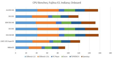

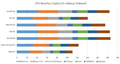

Hi, had some time to do some benchmarks with some CPU and Graphiccards.
I was really surprised by the performance of this Super33 cpu. The second graph is without Chris's 3D because it seems you need a FPU to do this and said UMC has none. Those tests were done with the onboard graphicchip.

I recently borrowed a UMC U5S Super33 from a friend of mine and benchmarked it on an Asus PVI-SP3 (PCI graphics card).
Overall, it performed more or less on par with a 486DX2 50 MHz, which is more or less consistent with what your benchmark results also show.
There is definitely no doubt that this CPU outperforms a 486DX 33 MHz (in terms of integer performance).
I believe that the 40 MHz version of the UMC U5S should be on par with a 486DX2 66 MHz.
Reply 2 of 2, by feipoa
Nice representation with the charts. I don't have to scratch my head to figure out what I'm looking at, except that my mind needs to subtract the grey from all other CPUs.
