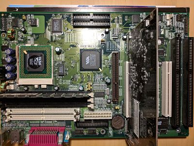

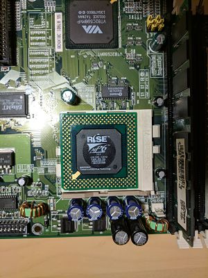

Hi,
I recently started playing with a SS7 setup including the following:
Motherboard: AOpen AX59PRO rev 2.0 bios 2.36
RAM: 256MB
Video: Radeon 7000 64MB PCI
CPU(s): Rise MP6 333 / 240Mhz (95x2.5) Lynx core
The usual Dosbench tests seem to look ok, will only mention speedsys here:
speedsys 4.78: 317.15 (it beats K6-2-266 apparently)
The interesting part is when I test Quake 2 with default OpenGL - results below:
800x600 demo1 16.5 FPS demo2 16.3 FPS
1024X760 demo1 16.8 FPS demo2 16.7 FPS
1280x960 demo1 16.6 FPS demo2 16.6 FPS
1600x1200 demo1 15.3 FPS demo2 15.1 FPS
Looks like the CPU is the bottleneck here - or is it anything else?
Same setup rocks with K6-2+ and K6-III+ - will add numbers for camparison later.
Photos included below.

Reply 1 of 26, by BinaryDemon
I assume the K6-2/3 CPU’s weren’t running Quake2 patched with 3Dnow?
I have no experience with Rise MP6, when I looked at the specs the L1 cache seems small compared with its competitors cpus (Cyrix 6x86 has 16kb too, but that’s not saying much). I wonder if Quake2 is a specific usage were small L1 cache hurts.
