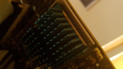

I have one of those amd 486 dx4 100Mhz cpus that say heatsink&fan required on the chip.
I currently only have arctic silver paste and this heatsink that was originally in a 90Mhz pentium system there temporarily but I don't have any fan I can attach to it.
1.54 MiB
1395 views
Yesterday I overclocked the cpu by changing jumper that changed the multiplier to 4 and I tested it as 133Mhz cpu. Because I felt unsure if it would overheat, I only tested it for 10 minutes or so. The heatsink was so hot that I was only able to hold my finger there for a second or less.
What kind of cooling I would need if I wanted to run it at 133Mhz in the future?
Would the cpu be faster if I ran it using 40Mhz fsb and 3x multiplier instead at 120Mhz?
Should I not run it even at 100Mhz with just that heatsink and no fan?

First of all, please don't do that, please don't abuse old and very limited stock items by overclocking. What's the purpose of running a 486 "faster" I really don't understand.
This aside, back in the days, CPUs were thougher, their maximum operating temperatures are much higher, so 60-70 degrees celcius was considered very normal. Just a as an example, my tiny teeny 386SX-16 from 1992 literaly blistered my fingers more than once (its operating envelop is 0 to 100 degrees celcius, according to formal documentation). It never had any cooling and was working in a cheapo AT minitower case, of which the only "cooling" comes from the PSU fan. And it still works after more than a quarter century later.
The first CPU cooling requirement ever come in to place with later 486 CPUs, before that nobody was caring about it for normal usage. And even then, the thing called "CPU cooling" was a "40mm shitty fan plus some flimsy tiny teeny heatsink" combination, in 99% of the situations. There was no "which termal paste is better" craze, because nobody was using them 🤣
In short, for a 486 class CPU, what you need is a decent heatsink and just to be on the safe side, a 40mm fan. Your heatsink looks like a good one (as you already mentioned, it is designed for Pentium class CPUs so it should be more than enough). I would add a fan on top of it (you can use proper screws, or just a cable tie to connect it) and be done with it.
For the 40 x 3 or 33 x 4 question... Which is faster is depends on what you do. But 40MHz is about the limit when you start having stability problems if you are using VLB cards in your system.
But again, what's the purpose? I would rather stick to the specs.

As already said - the fan made the biggest difference for me albeit for some more extreme cases you also may need a meetier heatsink.
I used a iDX4 at 2x66mhz and 5V for some time in combo with an Intel SS7 cooler... those last 13mhz were a battle.
The only real problem with heatsinks is if they can be correctly attached and ain't too heavy given you have positioned your board vertically in a tower.
Reply 18 of 28, by Baoran
That is the main problem, I can't see how I could attach a fan to the pentium heatsink and since the cpu is vertical only things holding the heatsink to the cpu are the sticky arctic silver thermal paste and a small lip the heatsink has.
So I in any case I am looking for a better solution to cool it.

You can find some scews that can get a hold between the heatsink fins. And cable ties might also help.
