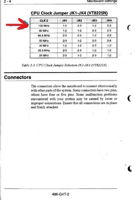

FIC GVT-2 and 3,3v, can i use an AM486 dx4 100 on it?
Because the manual shows only the jumpers setting for dx2 cpu..but another chart show del 100 Mhz cpu clock. i'm confused..

Reply 1 of 5, by Tiido
That board appears not to have a voltage regulator so it is 5V CPUs only.
Reply 2 of 5, by algernon
well, the manual reports a jumper setting for cpu of 100 MHz,
Wich cpu is running @100 Mhz and feeded by 5v?

Reply 3 of 5, by algernon
Cyrix 486DX2/DX4 Desktop Processor Technical Specifications
Clock Speed 33, 40, 50, 2/50, 2/66 and 2/80 MHz; 3/75 and 3/100 MHz
Clocking 2x clock multiplier for DX2; 2x/3x multiplier for DX4
L1 Cache 8-KByte; write-back; 4-way associative; unified
instruction and data
Bus 32-bit internal data bus; 32-bit address bus;
32-bit external data bus
Pin/Socket 168-pin PGA
Compatibility Fully compatible with x86 software
Floating Point Unit Fastest enhanced, integrated FPU with auto
powerdown
Voltage 5V or 3V core with 5V I/O tolerance for DX2
3V core with 5V I/O tolerance for DX4 <------------------------------ it's this meaning that i can put the Cyrix dx4 in my 486-gvt2 @ 5v without any voltage regulator of any kind?
