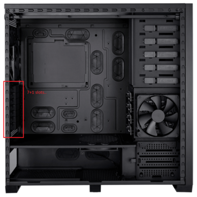

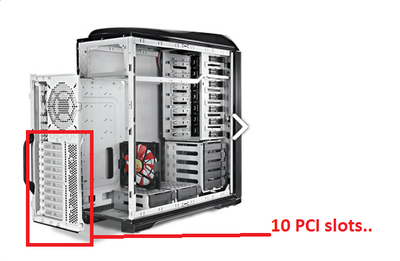

4) What solve space problems, some case mods, external cases, cable enhancers etc..

I did some case research for good big pc case which can be used without hassle with adapters - it means ATX 7 slots MB + place for at least 2 slots bellow it.. I seems that present age big towers are such good as use to be.
"Modern" big case Corsair 800D - 7 cards slots + 1 slot without headers (for cooler etc..):
1.21 MiB
4455 views
Old Thermaltake Armor+ full 10 slots..
152.61 KiB
4455 views
If you know good modern 9/10 slots case without door with at least one 5,25 position and PSU position at the bottom, USB3 ports and power bottom in front and at the top, no too much perforation and super bright leds.. pleas let me know. I know that i can just move PSU further in case and make more room for cards and do some driling, but i would rather not.
Reply 16 of 130, by PC Hoarder Patrol
Have you looked at the 9-slot Corsair Obsidian 750D? There were other 'older' cases with 10 slots like the Rosewill Blackhawk Ultra and the Xigmatek Elysium which you might still be able to pick up somewhere new or used.

Reply 18 of 130, by ruthan
Thanks for tips, i actually already have Corsair Obsidia 750D in one of my lairs, but i never counted slots..
Xigmatek - i dont like visuals, Rosewill - is much better, its usable, but i would prefer less perforations.
