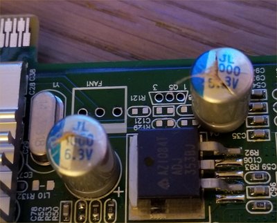

One question that I have is can I replace a leaking cylindrical polymer cap on a video card with a radial aluminum electrolytic capacitor of the same rating? That question probably sounds stupid, but I don't know enough about capacitors to know if it sounds stupid or not.... I'm not even sure if I am using the correct terminology.
In this case I bought a Geforce 2 that has two leaking cylindrical polymer caps. They are 1000uf 6.3v. I went on eBay and I can find radial aluminum electrolytic caps with no problem, but the cylindrical polymer caps are less common and more expensive.
Will the radial aluminum electrolytic caps with the same specs work fine?

Reply 4 of 10, by tegrady
Here are the caps. They are through hole.
I have replaced caps on a motherboard before, so I have a very basic idea of how to do it. (Not saying I am good at it).
My main question is whether I can replace cylindrical polymer caps with radial aluminum electrolytic caps, in general.
Thanks.

Reply 5 of 10, by Ozzuneoj
Failed polymer caps are relatively rare. Visibly leaking ones are even rarer I'd say. Those look like polymer caps, but they may not actually be. I'm not that experienced in this area but generally if they stepped up to polymer caps, there was a reason, so I'd definitely replace them with similar caps. Still... Seems very odd to have them fail like that if they truly are polymers.
A picture of the whole card, and the brand name may help too.
Edit:
Aha... I think I was right to be suspicious of those.
http://www.capacitorlab.com/capacitor-types-polymer/
They are standard wet electrolytic caps, they just don't have a sleeve. Polymers should have completely smooth tops with no vents at all (except for certain yellow ones I guess?). I'd never really thought about this before, so I'll have to make sure to distinguish these from polymers in the future. Normally polymers have odd capacitance and voltage ratings too.

What's the card? Can't find who manufactures that series, but they might not be polymer. Some are wet electrolytic in a polymer-like casing.
They look suspiciously like Sacon FZ caps, but I can't be sure atm.

Yes, I no longer believe they are polymer caps based on the previous post.
Also, it is an apparently generic Geforce2 MX400 128mb card. I cannot find a manufacturer's name anywhere on it.
Second that. That casing may be polymer-like but these are clearly failed electrolytic caps.
It's almost the new version of fake cache: fake solid/polymer caps. Fake and clearly unreliable too.

The caps are most likely for noise suppression or buck converter use. Poly caps, 6.3v and 1000uf with similar case sizes will probably work fine (not guaranteed, though). Still, a generic GF2MX might not be worth it. I'd give you one of mine if you were close -- I've got a few extra.
