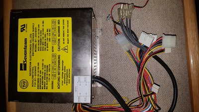

I took the psu out.
1.94 MiB
282 views

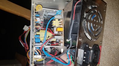

I opened it a bit.
1.87 MiB
282 views
Looks like there is a fuse I could try to change to a new one.
1.76 MiB
282 views
I just feel worried about touching there and I don't know where I could get a replacement fuse in case the fuse is broken so I put it back together for now.

Do a diode check on the bridge rectifier and impedance checks on the X caps (yellow bricks in the picture above) and filter choke. I suspect something has failed open on the primary.
Reply 6 of 7, by sf78
There's also quite a bit of dust inside that could cause all kinds of trouble so just to make sure I'd use compressed air to clean it up and examine it again.
edit: Is there any insulation (should be clear plastic film) between the bottom of the board and the case? It might be the camera, but the board looks a bit warped and some of those solder joints seem awfully close to the case which would short it.

There is some kind of insulation between the board and the case. You can see 2 layers in the picture and the layer closest to the board is some kind of foamy material.
