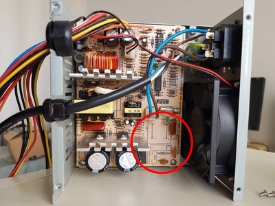

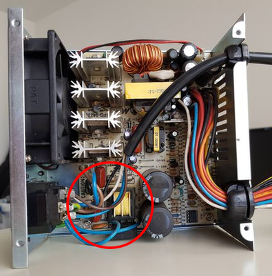

#3 morexplus PPS-200
#4 Morex 230w

Reply 1 of 12, by SW-SSG
The two that really reek of cost-cutting are the morexplus and the YoungYear. The others look alright enough; however, given how ancient some of those look (namely those last two), I would be suspicious of those capacitors even if they aren't currently showing any outward signs of failure.

The morexplus has missing input filter components, which are some of the first things to go with PSU corner-cutting, combined with small heatsinks and an overall relatively barren interior. The YoungYear (and the others) does appear to have input filter, but at the same time has no heatsinks and from there I start to worry about the quality of the other components, after being exposed to (I assume) more heat than they would usually experience in a PSU with proper heatsinking.
579.33 KiB
1522 views
morexplus; no input filter
365.43 KiB
1522 views
Morex; yes input filter
I can only assume that "morexplus" is some sort of value- or wallet-friendly sub-brand of Morex.
