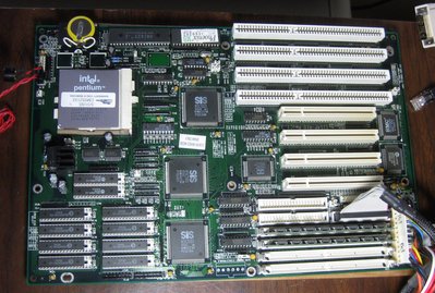

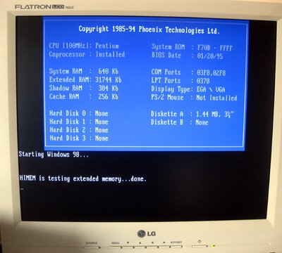

I'm working on an ECS SI54P-AIO rev 1.3 motherboard at the moment. While on first glance it appears to be working, it won't complete boot. The system passes HIMEM, then just stops. The only item in the startup files is HIMEM, but I've tried bypassing all startup files by pressing F5 at boot and the outcome is the same - hangs midway thru boot.
Thinking there may be an issue with the floppy controller, I used the jumpers to disable the onboard floppy and IDE controller and used an ISA card to serve as the floppy controller. The result was the same, that is, it hangs midway thru boot. I've seen this with other motherboards when some BIOS setting was set too aggressively, usually an SRAM timing. I'm tried disabling the L2 cache and putting the RAM on conservative settings, but the issue remains.
Has anyone run into this issue before? The BIOS is Phoenix and is from Jan 1995, which seems pretty old. I'll try the BIOSes located here, Re: ECS SI54P AIO full manual , but I'd still like to resolve the issue with the original BIOS.

Reply 4 of 16, by Predator99
Still think your problem is related to your boot disk. Himem.sys is loading, memory should be OK. I would try a DOS 6.22 disk next.
Did you wait some minutes if something happens after it hangs?
Disable shadow RAM and all unneeded devices like parallell/seriell port and IDE controller in your BIOS.
Reply 5 of 16, by feipoa
I took the heatsink off just for the photo. Yes, I plan on removing the label.
Yes, I waited a few minutes. I waited an hour even. It just hangs up. The floppy disk light stays on for about 1 minute, then goes out.
I've used this boot disk with dozens of other systems without incident.
I haven't tried disabling the serial ports specifically, but I can try. I tried changing a lot of options in the BIOS, but don't specifically recall if the shadow RAM was one of them. I'll check that again.

Reply 7 of 16, by feipoa
I was able to boot the system using the latest AWARD BIOS, however, there is a caveat, you cannot use this CMOS setting:
L2: Write-back
and
L2 bit length: 7-bit
This is the default setting though. WT + 7bit, WT + 8bit, and WB + 8bit all work though. I'm not sure what is up with WB + 7bit.
I then decided to put the original Phoenix BIOS back into the motherboard - this automatically resets the RTC memory when you swap BIOS types. And now the original Phoenix BIOS will boot. Strange. I'm now testing a much newer Phoenix BIOS from 10/2/1996. The original Phoenix was from 1/20/1995.
I guess the issue is sort of resolved. However, one odd bit was that the AWARD BIOS read the installed 32 MB as 8 MB, whereas Phoenix correctly reads 32 MB.
