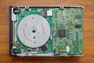

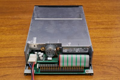

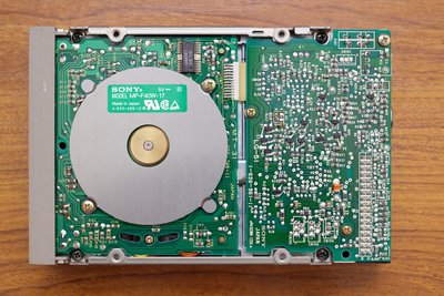

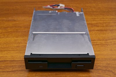

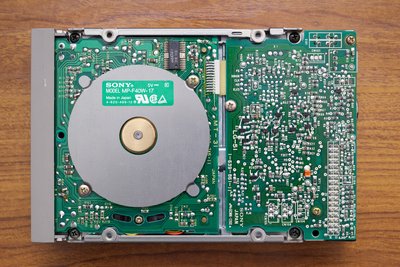

I am doing a collection of 2.88MB floppy disks and drives, where at the time of posting, I already have a TEAC FD-235J drive at https://www.ebay.co.uk/itm/TEAC-2-88MB-FLOPPY … &orig_cvip=true, a box of 10 JVC and 3M extra-high density floppy disks each, and 3 individual disks of other brands, totalling 23 disks.
I just successfully bid and bought a Sony MP-F40W-17 2.88MB 3.5” Floppy Drive, off an eBay seller at https://www.ebay.co.uk/itm/Sony-MP-F40W-17-2- … ?orig_cvip=true, after being outbid at the very last moment on almost the same MP-F40W-23 a couple of months ago at https://www.ebay.co.uk/itm/SONY-MFD-40W-21-Fl … ?orig_cvip=true, both of them were untested.
378.41 KiB
3680 views
Front of drive
415 KiB
3680 views
Back of drive

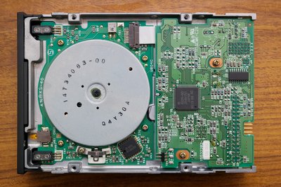

When I received and tested it, I found that although it could seek during POST, etc., it would not read my disks on nearly all IO controllers and motherboards.
When I used NFORMAT, it worked in terms of formatting and writing, but cannot read back from them. If I formatted the disk, with verify turned off, I could read back the formatted disk on other drives, controllers and motherboards.
However, on the Intel LT430TX motherboard, it initially did not boot from it, but after a retry it booted. It worked with 720KB and 1.44MB floppies, but not 2.88MB floppies, however formatting the 2.88MB floppies as 720KB worked fine.
When I checked the seller’s feedback of the MP-F40W-23 that I had missed out on, the seller received positive feedback from the buyer who is 100% enjoying, suggesting that the drive works, together with the box of 3M floppies that came with it.
Seeing that the lucky buyer’s drive worked, but mine with major compatibility issues, I compared the circuit board of the drive which was still on eBay to the one I have got, and found that one of the 0 ohm SMD resistors is in a different place, with three other missing.
I am aware that some floppy drives can be configured so that each pin sends and receives different signals according to the disk density, presence, etc. I have read at http://www.tavi.co.uk/ps2pages/ohland/floppy.html#82077SL that the suffixes on these Sony drives have different pin assignments.
I cannot find any other documentation of this drive on the web, other than 3.5” Micro Floppy Disk Drives from Peripherals – Pocket Service Guide at http://www.jope.fi/drives/diskettes-jumpers.pdf, which documents only the switch for drive 0/1/2 configuration, but not the SMD resistors configuration. The same documentation also documents the TEAC FD-235J, which enabled me to set the jumpers to be compatible with my QDI Advance 6T.
I therefore modified my MP-F40W-17 to match the MP-F40W-23 as follows:
- Moved the resistor from SL102 from A to B
- Removed the resistors from RJ14, RJ28 (points to just below SL103) and RJ40
733.65 KiB
3680 views
Before modification
745.04 KiB
3680 views
After modification
After the modification, I plugged it into my QDI Advance 6T in place of my TEAC FD-235J, did a DIR on my 1.44MB DOS boot disk, which successfully showed the directory listing! I also did the same for a 2.88MB disk, which succeeded too! SCANDISK, etc., also worked!
The only thing that is different between the two drives, other than my big saving, is that the bezel is non-standard for DEC computers on my drive, so I will have to find a standard bezel which will fit the drive.
I have now converted my MP-F40W-17 to a MP-F40W-23. If that eBay listing had gone after so long, I would have not been able to get it working. I hope that this will be useful to anyone else who are having similar issues.

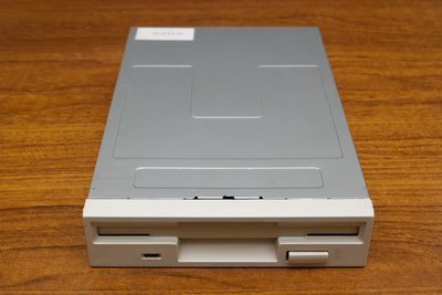

Reply 1 of 18, by s3freak
I found this Sony MP-F17W 1.44MB 3.5" Floppy Drive at https://www.ebay.co.uk/itm/Sony-3-5-034-Flopp … ?orig_cvip=true, where the physical layout of the drive looks very similar according to the diskette jumpers manual.
I therefore bought the drive very cheaply and did the swap. Other parts that I swapped are the bottom inner metal plate inside the drive that holds the little white button as this differs slightly, and also the top cover as the other was a little bent at one corner and full of stickers.

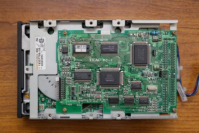

Reply 2 of 18, by s3freak

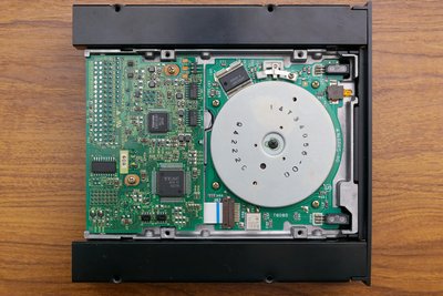

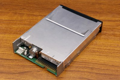

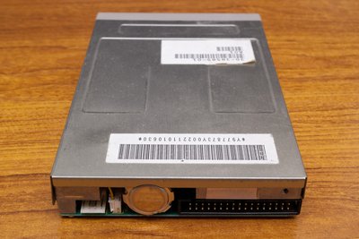

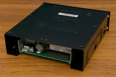

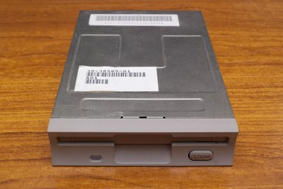

Over 18 months since I bought a TEAC FD-235J, I bought another that came out of a Nortel Meridian telecoms system at https://www.ebay.co.uk/itm/TEAC-NORTEL-Meridi … ?orig_cvip=true, which has a SCSI adapter board.
321.71 KiB
3562 views
Front of drive
451.07 KiB
3562 views
Back of drive
722.14 KiB
3562 views
SCSI adapter
Getting it to work with my PC was not as straightforward as removing the SCSI adapter and setting the jumpers to match my other TEAC FD-235J. As soon as I turned the power on, the power just cut out immediately due to a short circuit.
After doing lots of diagnosing and probing around with my multi-meter, I found that some of the pins of the 34 pin connector, 5, 7, 9 and 11, that is normally ground is 5V instead, which is how the SCSI adapter board gets its power. Like with the Sony MP-F17W-17, there is also a setting in the form of a 0 ohm SMD resistor to make those pins ground instead of 5V, which is to move the resistor from S2 to S1. I also took out the cable key notch.
694.05 KiB
3562 views
Before modification
724.1 KiB
3562 views
After modification
After plugging it in, hey-presto, it works! However, the FD-235J, suffixed with 5670, that I have just converted has to have the RY34 / DC34 jumper disconnected, otherwise the system thinks that the drive is not ready, even when there is a disk in it! With the other TEAC FD-235J, suffixed with 3653, the DC34 (disk change, across A3/B3) jumper is shorted, otherwise the system will think that there is a disk in it at all times, even when there is no disk in it, or the old disk is still in it after you had changed the disk!
I have also found that not all floppy drive controllers supports 2.88MB floppy drives. They may work with 720KB and 1.44MB, but not 2.88MB. Whilst I may do a compatibility list in the future, the motherboards (with onboard controllers) that I have found to be compatible are the Intel LT430TX and QDI Advance 6T and 10T.
I hope that this will also be useful for anyone else who are having similar issues.

Reply 4 of 18, by s3freak

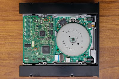

As for the original one that I bought over 18 months ago, I had a problem with the disk presence sensor that was sometimes sticking to on, despite correcting the jumper setting, causing the system to think that there is a disk present when in fact there is none, or the old disk is still present after it has been changed.
I bought a TEAC FD-235HF at https://www.ebay.co.uk/itm/TEAC-fd-235hf-3165 … ?orig_cvip=true, suffixed with 3165, as there are so many variations of this 1.44MB model. This variant has the same motor and sensors board, therefore a straight swap-out of the board fixed the issue. You will see that the board from the FD-235HF is much cleaner. As the LED sits inside the brown holder and is removable, I were also able to swap them, keeping the original yellow and green ones with the original drives. I also swapped out the rusted up screws.
614.81 KiB
3515 views
Original Board
612.2 KiB
3515 views
Swapped Board

Reply 8 of 18, by willmore
Hello, everyone! I'm a brand new member who found this thread vi Google. I have a couple of Sony MP-F40W-17 drives that I got very long ago--still in their pink poly sleves. I've wanted to use them as 3.5" ED drives, but I would settle for HD. I'm going to try to follow the directions of this post. So, thank you for that information. Before I do that, I thought I'd poke around on the PCB and see if I could find out what's going on. Here's what I found:
FDC Pin# 2 /DENSEL (controlled by RJ28/SL103)
FDC Pin# 3 GND (can't find anything on the back of the PCB that connects to it! Seems to be floating--no reasonable resistance to GND or +5V)
FDC Pin# 4 (controlled by SL106)
FDC Pin# 17 GND (controlled by SL104)
FDC Pin# 27 GND (controlled by SL105)
FDC Pin# 33 GND (controlled by RJ40/41)
I'm going to do the mod and see what happens. Several of the pins are jumpered to GND and that confuses tracing them. I'll see what I can find when I remove the resistors.
I hope that someone finds this as helpful as I found the info here. Thanks again!

Reply 12 of 18, by keropi
s3freak wrote on 2018-12-25, 12:45:
[...] I therefore modified my MP-F40W-17 to match the MP-F40W-23 as follows: […]
Thanks for making this info available s3freak!
I recently got a MP-F40W-17 and I removed Rj14-RJ28 and RJ40 as explained
In my case SL102 was OK but I had to move S101 switch to position 0
it works fine with 1.44mb disks after modification - no idea about 2.88mb ones - never saw one in person

I have SONY MP-F40w-15 from friend. Its NOS. After starting PC the led on floppy drive goes on and stays on. Anyone has one and it works on PC? It also has jumpers on side. Wanted to try 2.88MB floppys first time in my life and floppydrive does not work ;(
I have found only RJ40(no change after removing it). RJ28 is already missing from factory. RJ14 and SL102 is not on this model, or im not good in "finding Willi"
    1.7 MiB
    1507 views
    1.69 MiB
    1507 views
