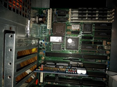

So, I've had this board for a while and I managed to fix some battery-damaged traces last year to get it up and running. It is having some issues again, so I'll need to investigate those further, but after looking at the board it occurred to me that I'd never really known much about it. This era is still very new to me.
Is the socket on this board only for 387SX co-processors or can it be used to add a 386DX? I can't seem to find any DX chips that use that type of package\socket, so I'm assuming it is just for a 387SX. Is there any other way to upgrade the CPU? I probably won't, I'm just curious.
How about the cache on the board. I've read that it is somewhat uncommon for a 386SX to have onboard cache. How much will this help performance, do I need to do anything to utilize it, and is it worth adding more?
Finally, the battery needs replaced but I have yet to find simple, specific directions explaining what kind of diode I would need to add to prevent the board from trying to charge a lithium cell, or how to install it. I can solder, but I know very little about the low level interaction of these kinds of components. If someone can explain this and show with a simple picture where to solder it, I'd be most appreciative.

You can't upgrade 386DXs, all you can do is oc it (or solder a faster chip if you have the skill). But you'll be stuck with SX CPUs, DX CPUs need a wider bus.
As for the cache, it may not be useful if you manage to get the fastest timings on your ram. On my 386SX25, I managed to maximize what the CPU can do, so cache wouldn't have been useful. However if your bios don't let you do that, or you don't have fast enough ram, cache will be useful

The cache does wonders for 386. You get a amazing boost going from cacheless to 64KB, going fruther up to 256KB gives only a small bump.
Why don't you replace battery with similar new NiMH barrel type battery? They are quite cheap on ebay/aliexpress.

Reply 11 of 22, by quicknick
Your board looks quite similar to one that gave me some headache in the past (here). If you have the means, please attach a dump of your BIOS chip, and also please test your board with only two SIMMs installed. Being a SX it should work, but mine doesn't.
For the battery, I strongly suggest using an external pack: 3*AAA cells, either NiMH connected to the same spot where original barrel was located, or alkalines at the external battery header (J1, near the keyboard connector). Here's the board that most closely resembles this one. There are some differences, but the jumper settings are identical from what I found.

Anyway, I think I've finally figured out the battery charging. I have found one thing that concerns me though. I disconnected the internal battery charging circuit the other day (lifted one end of a diode that leads directly to the + terminal of the internal battery) which got rid of the 5 volts I was measuring across those battery terminals. Once I figured out how to wire the external battery header (it looks like it should be pin1= positive, pin4=negative) I decided I'd better check that for voltage too when the system is running. For some reason, I'm measuring .04v coming across the external battery terminals with no batteries installed. To me, this looks like it is intended for trickle charging? I still get no continuity between the 5v pins on the AT power connector and the positive external battery pin (where as there was continuity from +5v through a resistor and a diode to the internal battery + terminal), so I don't know what that means. I've read that alkalines can technically be recharged if done slowly, and a .04v charge doesn't seem like it would be enough to do damage, but I want to be sure before I insert the batteries and power on the system.
What do you guys think?
Reply 16 of 22, by Tiido
That 0.04V is some sort of leakage current that passes the remaining circuitry (i.e through a chip via ESD diode or something). It isn't a thing to worry about.
Reply 17 of 22, by Ozzuneoj
Wonderful, thank you! It has kept all of its settings with the battery installed for a couple hours now.
For anyone else who finds this board, this page's explanation of the external battery header appears to be correct, except that the wording is too vague. The internal battery would require a jumper on pins 2-3 of J1 or it will not keep CMOS settings. The external battery would require the positive battery terminal to be connected to Pin 1 and the negative on Pin 2 (ground)... apparently this is what it means when it says "CLOSED" for the whole connector 😵 . I am not that great at understanding circuits, but as far as I can tell from probing around, this should be accurate. It is currently running with 3xAAA alkaline batteries and there is no smoke, fire or bad smells escaping from any components, so it appears to be fine. I had already disconnected the diode from the charging circuit (thinking it'd be possible to use a CR2032, but it didn't provide enough voltage) so I am unsure if the charging circuit would have any effect on the external battery header. I don't think it would though.

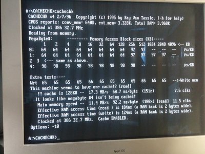

The computer seems to be working great, but I ran CACHECHK and noticed something odd. It said that "Megabyte #4 isn't being cached". Is that accurate? Is it normal?
I checked the cache jumpers and they're all correct. I even added another 64KB cache and set the jumpers for 128KB and it still says it. Here's a screenshot:
1.17 MiB
1062 views
The system has 4MB of RAM. Running a memory test in checkit shows that all is well.
