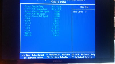

I've been using this cheap 120W Chinese PicoPSU knockoff with the signature PC for about a year now, and so far the system has been stable as a rock, even at the maximum overclock. Not sure if it's regulated 12V or not.
549.54 KiB
1576 views
Would still want to go for the real thing someday for peace of mind though, but the shipping cost to Russia is out of control 😀

doaks80 wrote:
I noticed a number of them on eBay give ripple and max/min rating for the 12V rail...which seems only possible if regulated.
Can I ask what AC/DC you use to feed the PSU? What is the output amps? Also, what system are you powering with what components?
Thanks, good to know!
It's just a generic 12V x 10A power brick from the same seller. Nothing to say about it, really - other than that it emits a faint coil whine when the machine is not turned on (ATX pilot current). I heard you can make a pretty nice 200W AC/DC out of an XBOX' original PSU.
How much power does it draw from the wall is a mystery to me, as I don't have a meter. I bet it's something around 60 or 70 Watt.
The system is a Celeron 800 (sometimes @1066 Mhz), GF2MX 32MB, 1 stick of 512MB PC133 RAM, 1 PCI sound card, 1 USB Wi-Fi dongle, an SDCard-to-IDE adapter, 1 80mm fan at 7V and occasionally a USB DVD drive. I've also had it running with a PCI NIC + 2 256MB RAM sticks + IDE DVD drive - no problems there either.

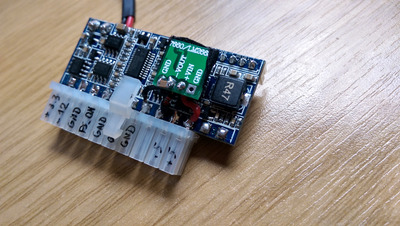

Hi, I posted that design in this topic: AT PSU design (question about output overvoltage protection)
here is a prototype for T3200SXC DIY AT DC-DC power supply (replacement for Toshiba T3200SXC and others)
unfortunately I didn't go beyond a prototype and I think this design should be modernised, for example throw out the relay and SCR and replace them with MOSFETs, etc (I'm not particulary good in designing more complex electronics) 😉 right now my solution for more powerful, but still reasonably small AT PSU is SFX form factor power supply with ATX - AT adapter...
And if you just want Pico PSU with -5V, you can piggyback a LM2662 module, this is what I did recently:
747.98 KiB
1072 views
it should be also possible to remove the ATX plug and solder AT connector wires directly. Pico AT is done 😉

That's the reason for installing LM2662, it is a charge pump which converts positive +5V into -5V 😀 you solder +5V to +VIN on the module, and -VOUT goes to the -5V mainboard connector. -12V remains untouched in this scenario. LM2662 should provide up to 200mA, maybe less in real world conditions, but that should be enough.
