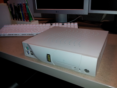

Reply 10 of 13, by xjas
Tip: thin clients (or anything) with the VIA 82c686b southbridge will have excellent DOS sound compatibility and good Win98 support too. No need for an ISA slot. It's usually found on Kx133/PLE133/sometimes Kx266 chipsets & paired with Socket 370 VIA C3 CPUs or Celerons.
I have one of these Termtek TK-3350 thin clients based on said chipset. It makes a perfect tiny DOS machine; compatibility is pretty good & the onboard video is really decent for DOS stuff. The 533MHz VIA C3 is roughly on par with 266MHz PII in 3D games. I originally had an IDE laptop hard drive installed through a bunch of adapters, but since it died I'm just running JoJo's "PC/DOS MINI" image off a USB stick plugged into the front.
The BIOS will map USB memory sticks, floppy drives, or CD/DVD drives to drive letters for non-USB-aware OSes (e.g. DOS) and you can boot off them.
474.87 KiB
1796 views
Best of all, it has a standard IEC C14 jack for mains power on the back; you don't even need an external power brick. Great little box.
