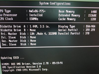

Reply 6 of 11, by seanneko
Well, if you set the FSB to 50MHz it identifies the CPU as an Am5x86. I know it's still running at 3x multiplier, but it at least shows that the BIOS knows about this model of CPU.

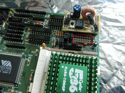

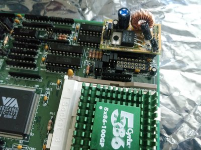

Reply 7 of 11, by seanneko
These are the jumper settings to get the Cyrix 5x86 working. It shows up as a 5x86-S 100MHz.
Still no luck on the AMD 5x86...

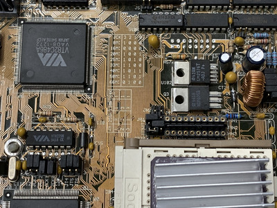

Reply 9 of 11, by Horun
I see there are no jumper packs in the sockets, should there be ? They look like black resistor packs but are actually jumper blocks.
Just curious because your board and the manual do not match (it is late so might have missed the details)

Reply 10 of 11, by douglar
https://stason.org/TULARC/pc/motherboards/F/F … EO-486-VIP.html
Resister pack in JRN2 for 3.3 Volt operation
JCK0: 2 & 3 - 33mhz
JCK1: 2 & 3 - 33mhz
JCK2: 1 & 2 - 33mhz
JCK3: 1 & 2 - 33mhz
JC2: 1 & 2 - DX
JC3: 1 & 2 - DX
JC4: 2 & 3 - OverDrive
JN1: Open
JN2: Open
JP1: 1&2
JT2: 2 & 3 - 2x Multiplier
JT3: 1 & 2 - Writeback Cache Enabled
JT4: 1 & 2 - Overdrive Disabled
