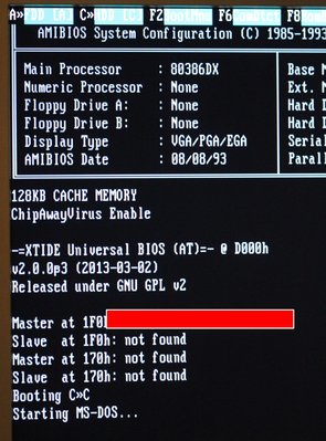

Hi! I got negative result with compatibility W27E512-70 and 3COM 3C509B-C .
I programed the W27E512-70 with the BIOS (version BETA 2.0.0.3+). This picture was taken when I read the chip to verify.

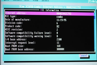

The chip was plugged in the 3COM boot socket:

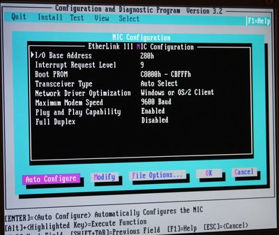

But the 3com configuration program always give me the following error:
Obviously I've tested all base address with the same error.

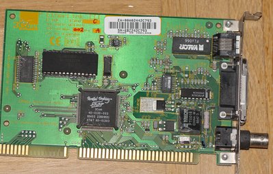

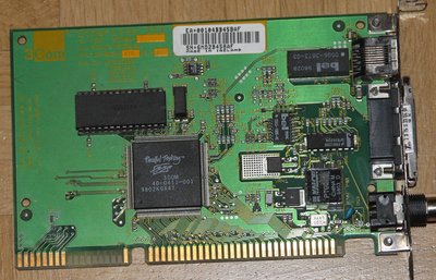

I cannot confirm, have it running on a 3C509B-C (mine looks slighlty different) and a W27E512. I also remembered to have difficulties with the 12kb and used the 8kb. Its a good point to start. However, the card-Setup shouldnt care about it. Check your memory, do you have emm386 running or BIOS-shadowing? Turn both off....

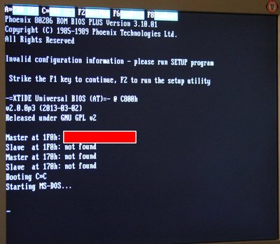

Sorry, but most hints here will not solve the issue. The NIC doesent check the ROM content. The error message say that it cannot find a free ROM-space. Thats the only problem.
So either clear up your memory or your card is damaged (whcih is rather unlikely when you take a look at mine which is still running)
