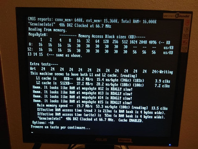

Sorry for the necropost.
I'm messing around with this mb.
Apparently it doesn't like to work with 1024kb of cache, it makes up to the post screen but then it hangs, I was able to make it work with 512kb (128K x 8 ) with 128k as tag, chinese IS61C1024-10N.

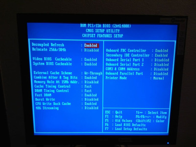

I'm testing the stuff with a virge dx pci video card, an intel dx2 66, 16mb of memory, with latest bios version 4.27GN2A (02/14/96).
In the bios chipset features setup there are some interesting options, those are the options which I get the best result according to Cachechk:
84.47 KiB
327 views
best bios options
Those are the weird results:
122.04 KiB
327 views
results
There is this weird warning about slow memory.

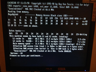

Strange enough with write back cache I don't get the warning but the results about the ram are noticeably worse but I get rid of the slow warning message:
117.74 KiB
327 views
write back
Another weird thing if I go with cache timing to turbo, the results keep being the same, another thing to notice, I am unable to use the burst write option, otherwise the system reboot automatically as soon as dos is loaded
