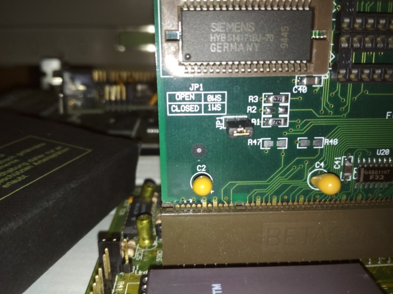

One of the best items in a huge haul I did yesterday was an Ark 1000VL VLB card.
It looks clean & undamaged enough:
But on boot this is the output:
NOT what I wanted to see :depressed:
Now, my first thought was that this was video memory related. Only the two 512kB sockets are populated, and I have enough other cards with the same kind of chips. I exchanged the two 70ns ones in the 1000VL with two 50ns chips from a Virge. Result: completely unchanged.
Now, the only thing I noticed on a thorough inspection was two SMD pads that did have blobs of solder, but no component, at location R2:
However there's no indication anything actually was ever there, and the only other good pic I could find of the same revision board doesn't even have the solder blobs there:
So... anyone have any suggestions about how to troubleshoot further or fix?

Postby Ozzuneoj » 2019-2-19 @ 03:29
Cool card! Wouldn't be surprised if this turned out to be the fastest VLB card out there... I'd like to see some benchmark results once it is fixed. :)
Check for any bent legs on the main ARK chip, if you haven't already.
Check the tantalum caps to see if any are shorted (continuity between the legs of a cap).
Clean the VLB contacts with a pencil eraser.
Check for any tiny scratches or dings in the PCB that may have damaged a trace.
With a very good magnifier check for any broken solder joints, especially on the (populated) RAM sockets. This is very very common with cards of this age. If they've been mishandled at any point there's a good chance one of the legs from a through-hole component will have gotten tugged on enough to break free of the solder. It might be very hard to tell.
I use one of these when inspecting broken solder joints, it works beautifully, though there may be more convenient devices for this.
Poke the various parts of the card while its running to see if the lines change, this could help pinpoint any physical issues. (broken traces, broken solder joints, etc.)
I'd be very very surprised if it wasn't fixable. Basically, anything other than an internal defect in a non-replaceable IC (like the ARK chip) could be fixed. One bad trace or a bad solder joint are actually very easy fixes if you're somewhat experienced with a soldering iron and have the tools.

Postby Tiido » 2019-2-19 @ 04:53
How do the lines change in different video modes ?
Since it is in text mode I am suspecting the connection to RAMDAC or the RAMDAC itself being the problem.

Postby dionb » 2019-2-19 @ 09:28
At first glance the legs of both the 1000VL and the RAMDAC look good. I'm not sure if I have enough DIP RAM chips of the correct size and speed to populate those sockets. I'll have a rummage through my boxes this evening for those. This card gets prio over anything else I have in any event ;)
I'll check the different modes this evening too, and the tantalum caps (I assumed they wouldn't be the problem as they'd short the whole card out).

Postby dionb » 2019-2-20 @ 00:14
Hmm, looks very familiar - but all the pins here are straight.
Didn't have as much time to look into this as I hoped. Still not found enough 70ns or better DIPs to try that. Did quickly boot it up to see how other modes looked. Same number of pixels between lines it seems:
Not sure what that means...
