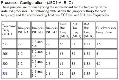

Reply 8 of 17, by PC Hoarder Patrol
According to Intel the board is listed as supporting up to Pentium II 333 MHz with 512KB L2 cache (qualified) and Celeron 333MHz (unqualified)

Reply 17 of 17, by Katmai500
The 300 MHz Klamath and 333 MHz Deschutes will also work in the PD440FX. You need to update to the latest BIOS to support those CPUs. The Intel PD440FX manual spec update explains this and includes the appropriate jumper settings, just like PC Hoarder Patrol posted above. I've tested this personally on my own PD440FX board.
