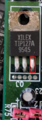

Reply 80 of 102, by Deksor
Well uh I'm sorry but THIS is the pin that I want 😊
90.75 KiB
424 views
Also, I think I'm going to buy the chip that's missing from mine as, according to the datasheet, it seems to play an important role in the voltage regulation domain. But there seem to be many version of it, and I'm not sure which one should-I buy. And I don't know much in electronics further than "this capacitor is bad, replace it; this trace is dead, fix it; this resistor is missing, replace it; etc"
alternative
Reply 82 of 102, by treeman
ok, well that pin is covered then in my previous posts, the blue line has continuity to first and second solder points from the edge of the board which "chip" are you talking about?

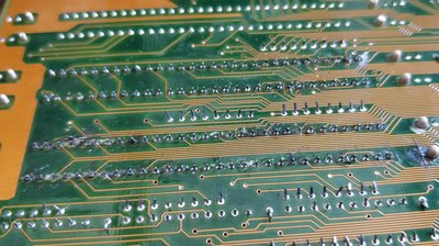

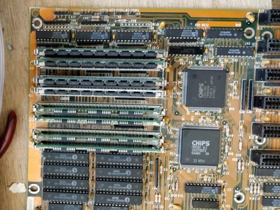

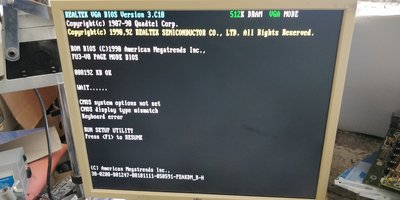

Reply 90 of 102, by Deksor
Hey it's been a while !
I haven't done much recently, I'm waiting for DALLAS chips to arrive, and I should also order that missing resistor/chip for the ATC1415.
But today I was working on cleaning one of my working ISA I/O card because it's quite rusty and full of dirt (almost like the card had some mud on it or something like that) so I had to remove the parallel/game ports using the desoldering iron.
And since the iron was hot I thought "why not trying to desolder some 30 pin RAM slots from one of the donnor board ?" (I was kinda lazy to do that because that donnor board is actually quite resilient to "give" its components, or at least I thought it was because this time I had no real problem - maybe I'm just getting better at desoldering things with that desoldering iron ? - but also because it's a bit boring actually ^^). Anyways, so I successfully removed four 30 pin RAM slots from a dead 486 motherboard, and I brought them to the ABIT FU3 (the 386DX motherboard)
1.33 MiB
318 views
Tadaa !
1.89 MiB
318 views
It still looks nasty, but what can I do now ?
1.37 MiB
318 views
And here's the front
I chose to not remove the other four RAM slots from this board even though they look a bit rough : too much work for too little (they work very well and the board will always look rough even with new ram slots, plus it's not like they had oxydation that could become worse after a while)
So I think that board is now totally fixed 😁 It just needs some cleaning and then it'll be ready to find a new metal home

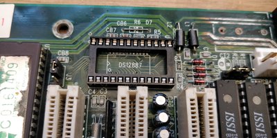

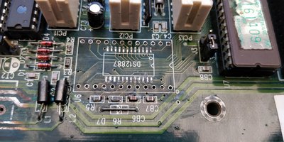

Reply 92 of 102, by Deksor
Great, I've finally received my DALLAS chips 😁
So I've removed the old rusty chip from the ATC1415 and I emptied the holes (that was much tougher than I expected ! The oxydation was really annoying to deal with)
1.58 MiB
248 views
And now the new socket ^^
1.33 MiB
248 views
After a short test, it works flawlessly. Before that, just reseting the board was enough to lose the settings (I'm not even sure the old chip was really working to be honest. The previous owner tried to do something with it as I saw some flux on pins in a corner, but he stopped at some point).

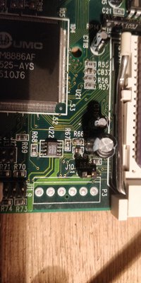

Reply 95 of 102, by Deksor
Here we are again ! So I've received the resistor and the chip and I've soldered them on the board.
1.08 MiB
210 views
Not my proudest solder job, but it's good enough for the moment (and I've lost my flux pen 🙁). So +5V for the CPU is back, but I'm still not getting the correct voltages concerning the +3.3/+3.45/+4.0V settings. (I get 1.8/2.0-ish volts instead which isn't enough to run anything of course)
Now I start to suspect the capacitors (the previous owner has definitely done something with them since the solder on their legs isn't looking like proffesionally soldered). Could bad/wrongly sized caps prevent the voltages from being correct ? If so, can I have the original capacitors specs ? (I don't really trust those on my board, maybe they've been added by the previous owner).
alternative
