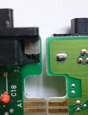

I bought this card a while ago on ebay (CGA - III / P)
5GmN3f4l.jpg?1
It kind of fitted in my turbo XT case, but since I moved the motherboard into an AT case it's a much tighter fit. Of all the ISA cards I've encountered, this one definitely seems to be non-standard: the part of the pcb with the bracket seems to be too long, and the pins don't align properly with the ISA connector on the motherboard (they're actually off by one pin). I had to remove a screw from one of the 2 motherboard spacers, and try to push the mobo as far back as possible from the case slots. Now it fits but it's really tight and I don't like the amount of flexing on the motherboard (see picture).
zIRVcS8l.jpg?1
Have any of you ever had to deal with such cards and if yes, did you manage to mod them?

Welcome to the wild-west of loosely standard vintage PC hardware. I have motherboards the ISA slots of which, regardless of what case I mount them in, do not line up perfectly with the expansion ports. Shit happens. Don't brute force it in, but if you are gentle but persistent enough it will ease in, however awkward it might get. Kind of like sex.
Reply 6 of 12, by derSammler
If you inspect the ISA slot closely, you'll see that it is actually not soldered correctly. It's not an issue with the card. On the left, the distance between the slot connector and the motherboard is wider than towards the middle. On the right, it gets wider again. I've encountered this with many mainboards. Often, you fully insert a card but the top of the bracket is still floating in the air, or as with your case, vice-versa.
Reply 7 of 12, by keropi
You can try remove all screws from the bracket and leave only one at the top not fully screwed: then insert the card in the slot , make sure it sits OK and then tighten that lose screw on the bracket. Chances are it will fit OK with the extra wiggle the bracket will now have...

I have filed off a little bit of the rearmost edge that goes in the slot to reduce the stress. But I first just loosen motherboard screws while cards are in, wiggle stuff into the best possible alighnment and tighten the screws again.

Right, I got the bracket off, and comparing this card to another similar-sized one, the problem is immediately apparent: the PCB is too long
It's only a difference of 2 or 3 mm but that's enough to cause a problem.
